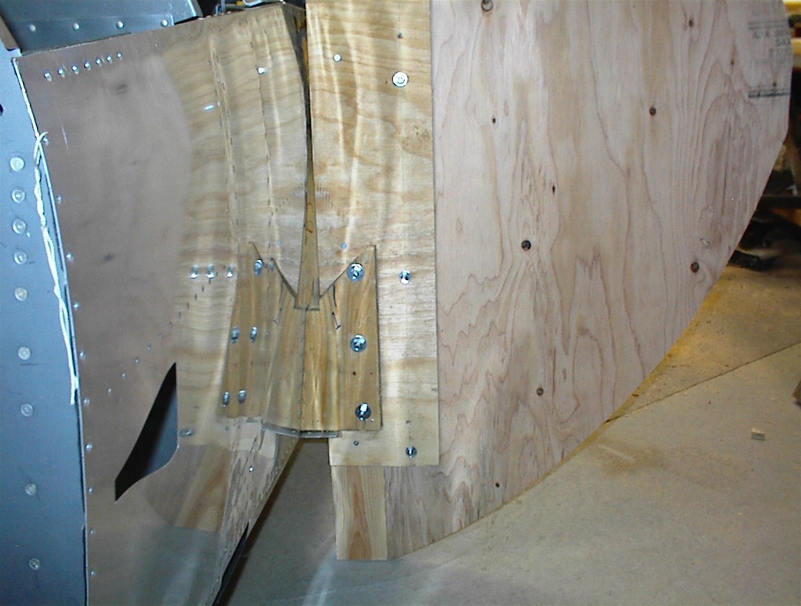

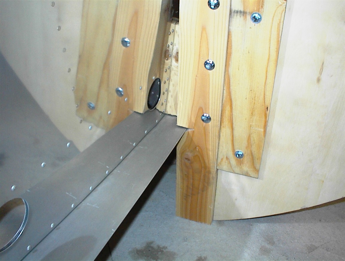

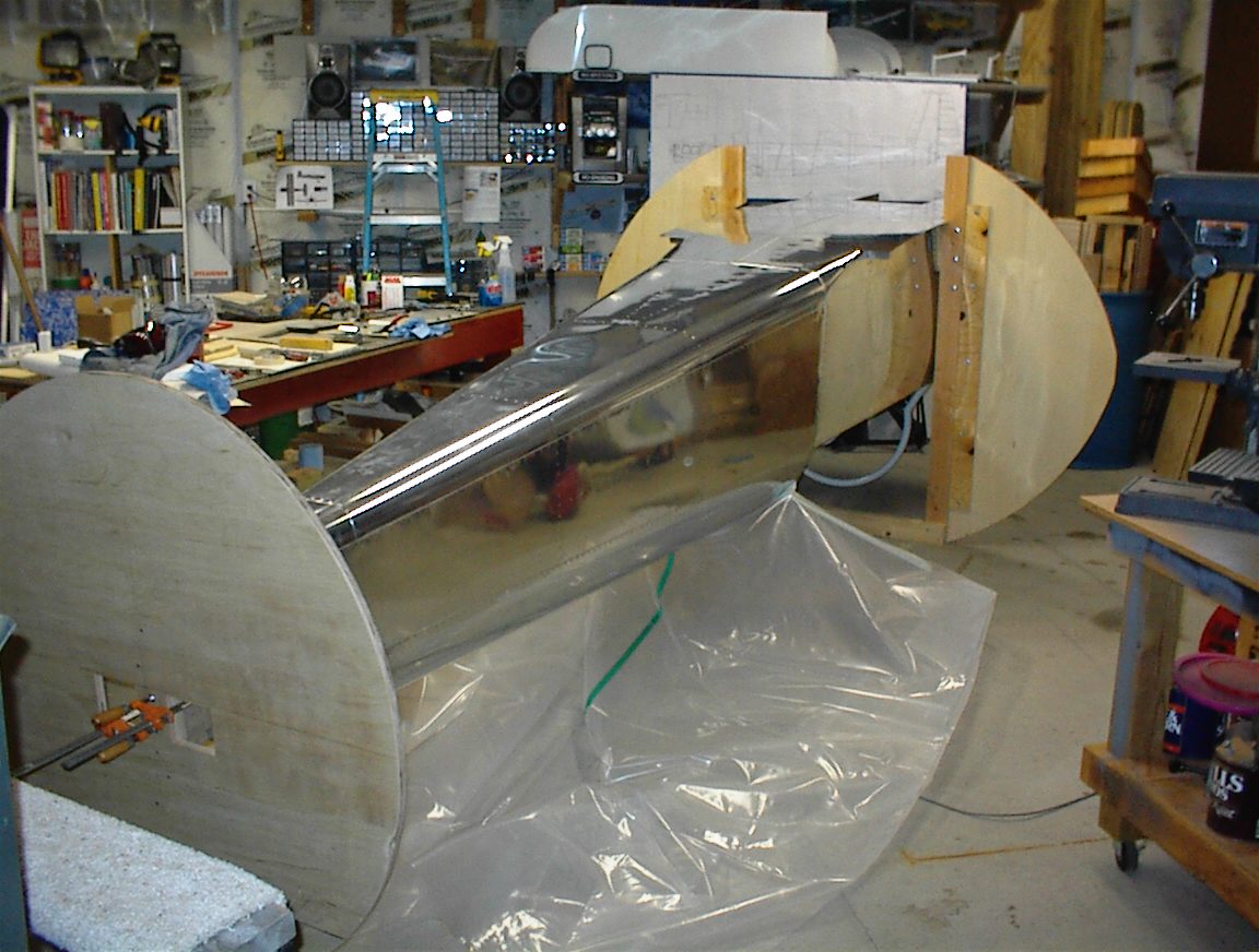

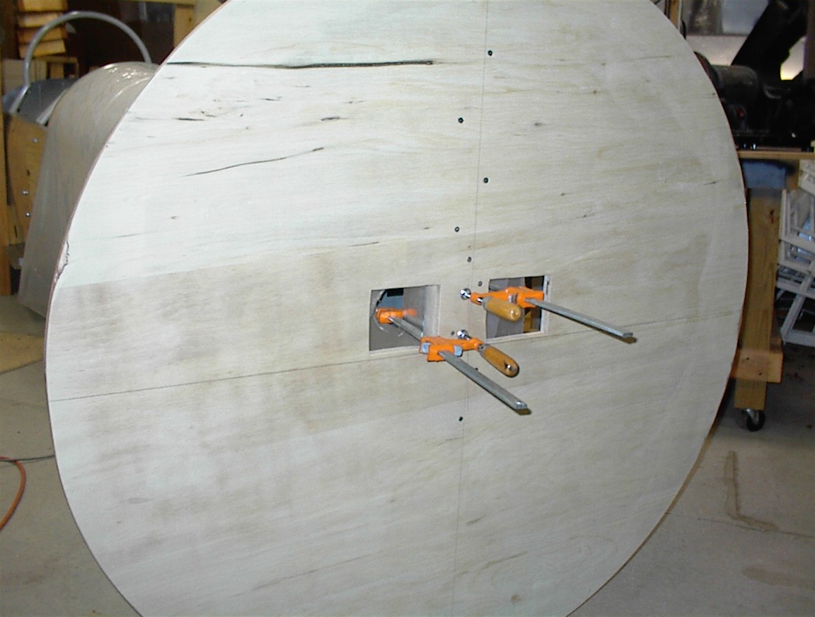

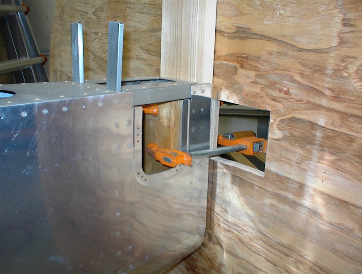

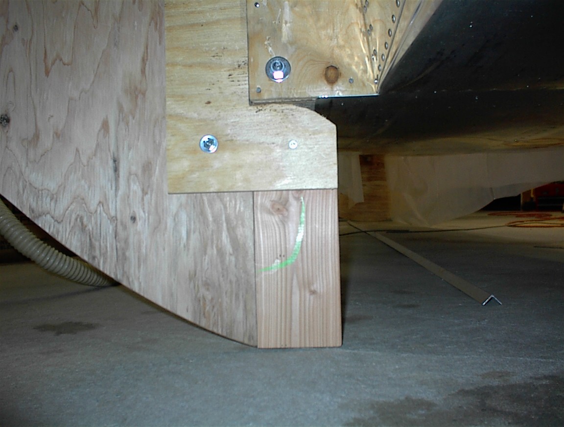

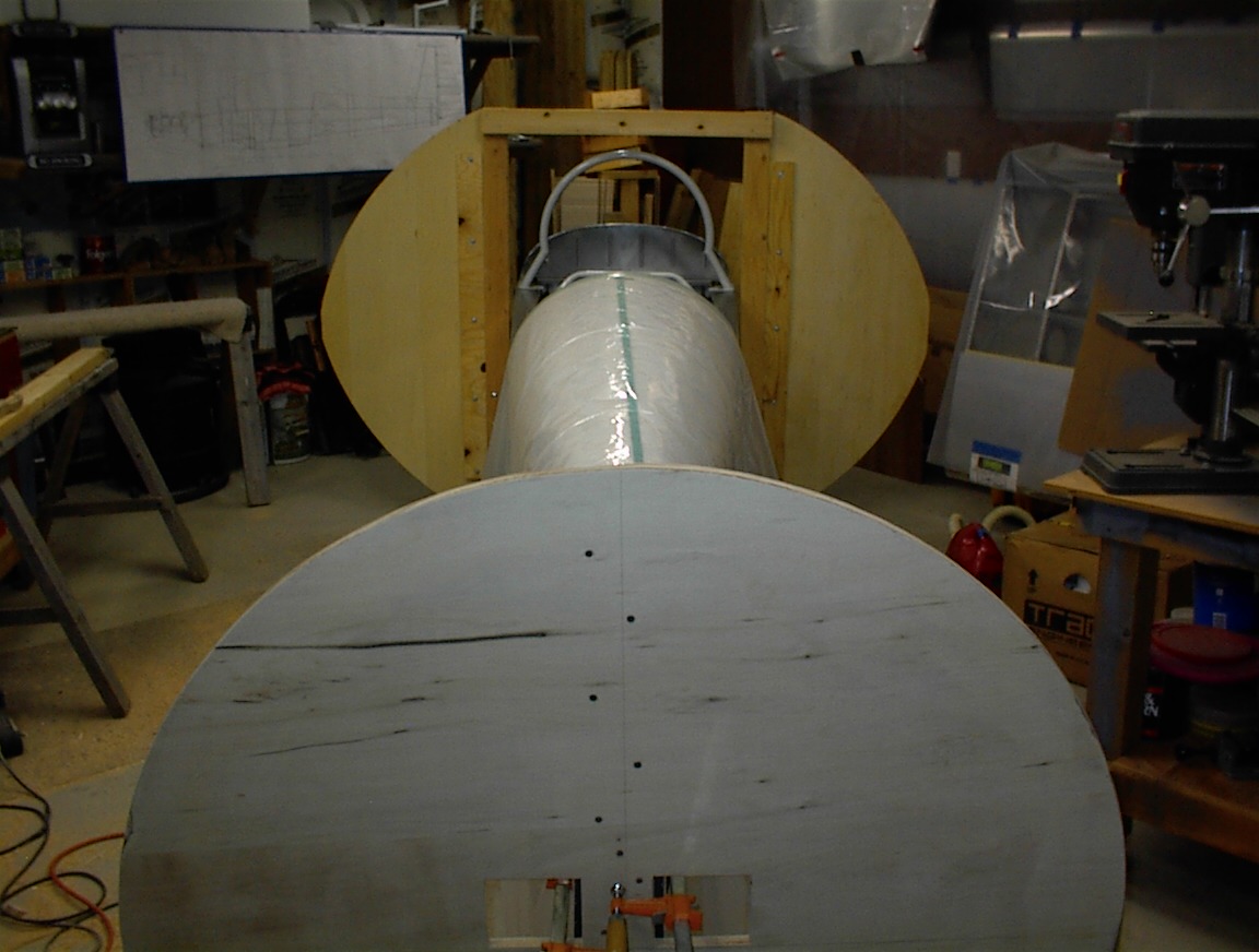

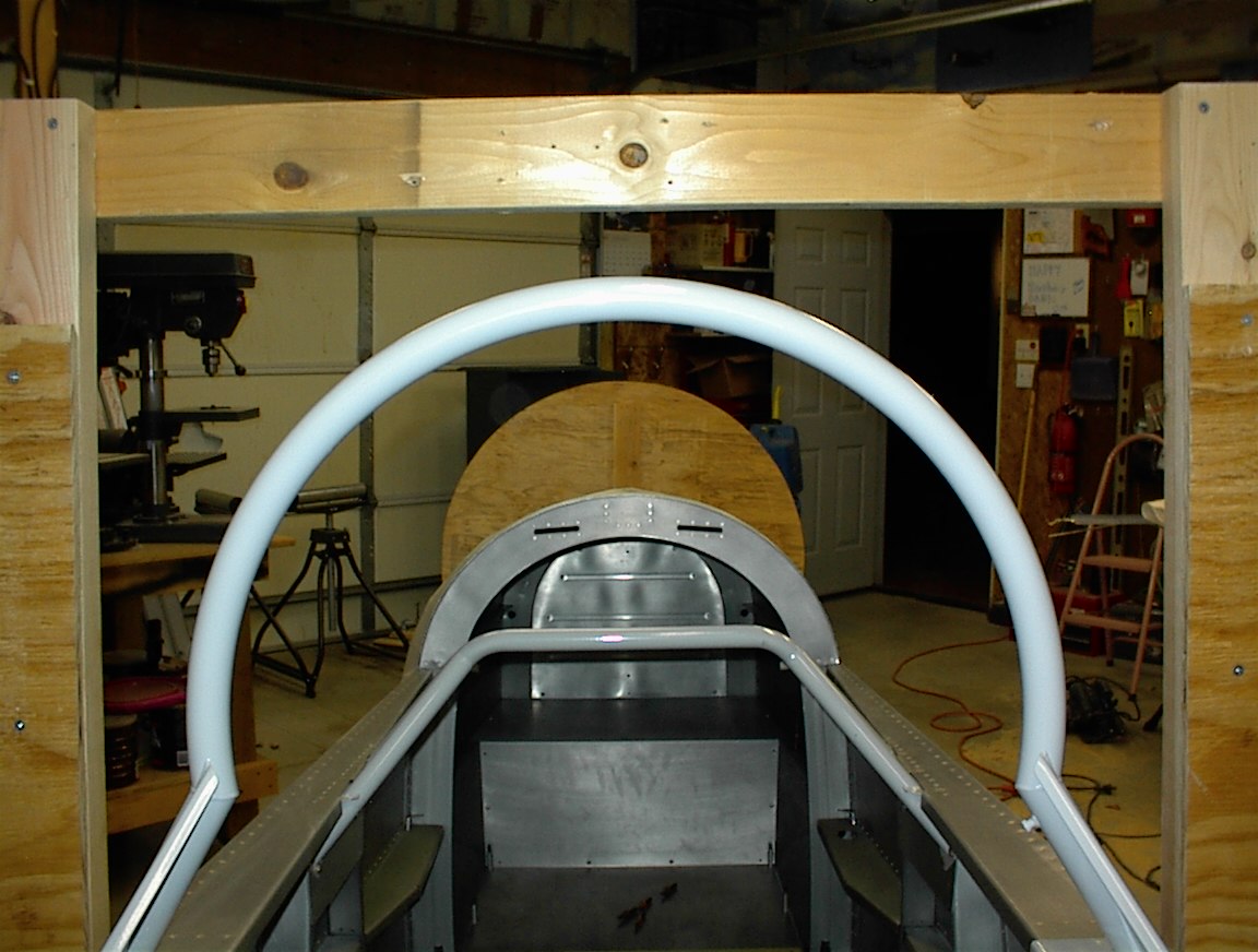

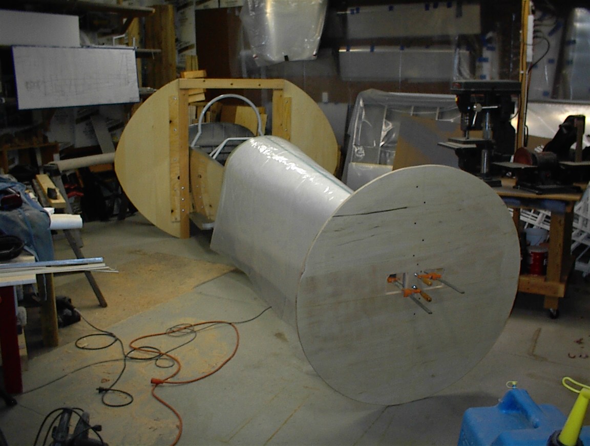

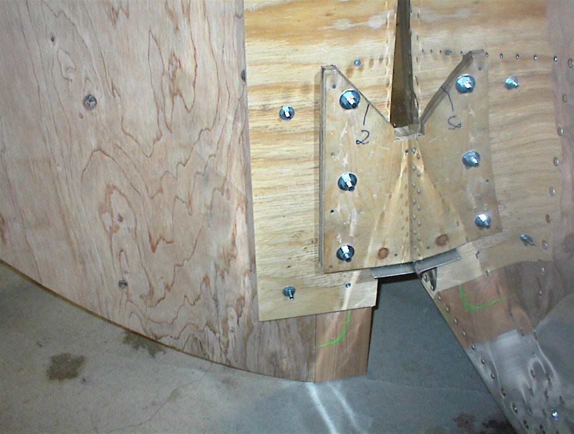

Subject: Fuselage Roller Description: Lister Tom Garner posted some photos of this handy one-man fuselage jig from which I made mine out of plywood and 2 x 4s. When you're working on the fuselage by yourself and want to rotate the fuselage for easier access, it's a simple matter of rotating the jig. To do it "in place", simply rotate, slide, rotate some more and slide. Thanks, Tom
011106.10_fuse_rolr_lkng_fwd.jpg Rear Looking Forward 011106.1_upsd_dwn_fuse.jpg Upside Down - Ready For Gear Legs! 011106.2_fuse_rolr_aft_cup.jpg Aft Attach 011106.3_fuse_rolr_aft_cup2.jpg Aft Attach 011106.4_fuse_rolr_lfwd.jpg Left Side Forward 011106.5_fuse_rolr_rfwd.jpg Looking Rearward 011106.6_fuse_rolr_rfwd_cup.jpg Looking Rearward 011106.7_fuse_rolr_lfwd_cup.jpg Front Cutout Detail 011106.8_fuse_rolr_lkng_aft.jpg Overview 011106.9_fuse_rolr_lfwd_cup.jpg Front Cutout Detail 011116.1_fuselage_roller_lrear_qtr.jpg Left Rear Shot 072901.jpg Lyle's Throttle Quadrant
