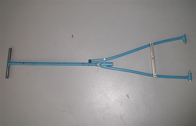

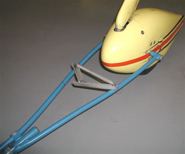

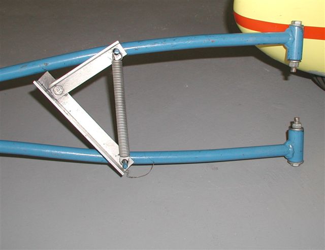

Subject: RV Tow Bars... Description: Seems like newcomers are always asking about tow bars so here are some pictures of my modified cessna type tow bar.I made an over center bar to hold it open while connecting and at the ends I used a couple of pieces of hose slightly longer than the end hole and with large washers and a 3/8 bolt squeezed it tight. Works great. -Ollie 6A N795LW Central Fl.
