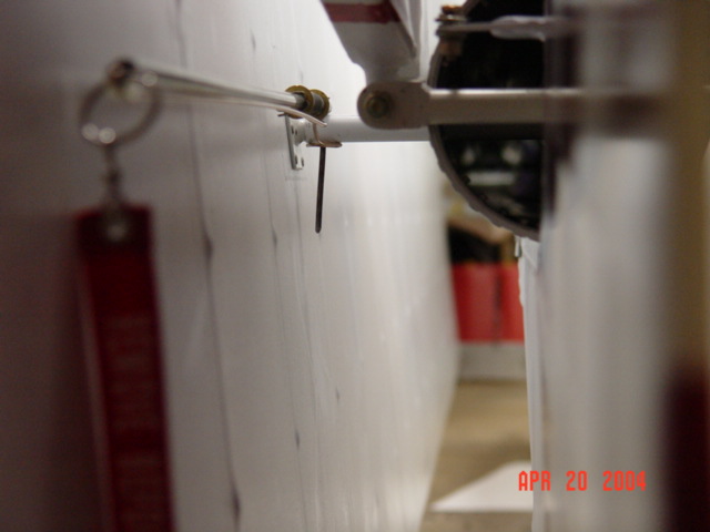

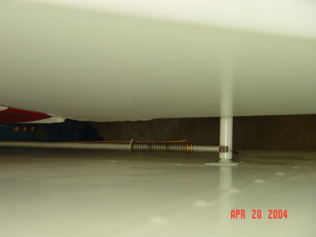

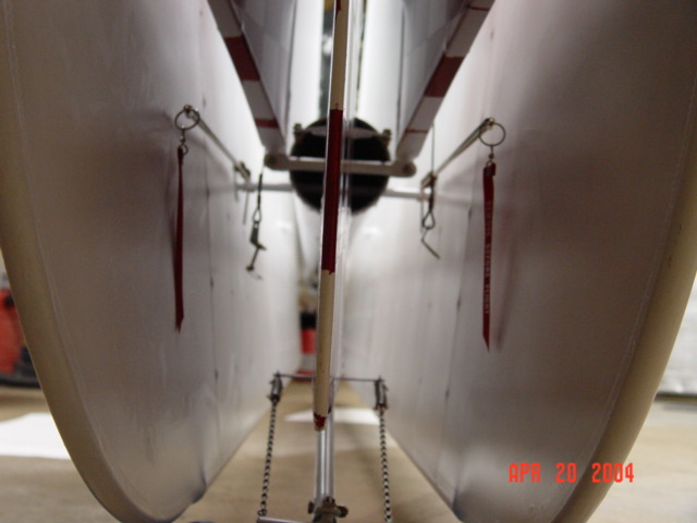

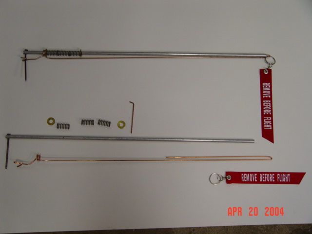

I drilled my wing fold tube "holes" Vertically. I made these pins out of 5/16 alum tubing and a nail (rounded) I was afraid the pin might "climb" out of the hole while bouncing on a trailer, so I made some spring loaded "keepers"....the wire I used is a TIG welding rod... Their easy to install from the rear of the plane.
