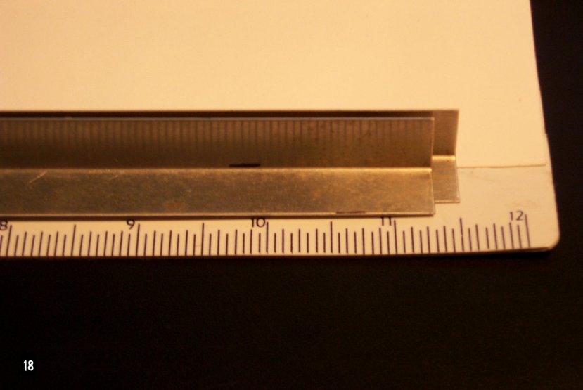

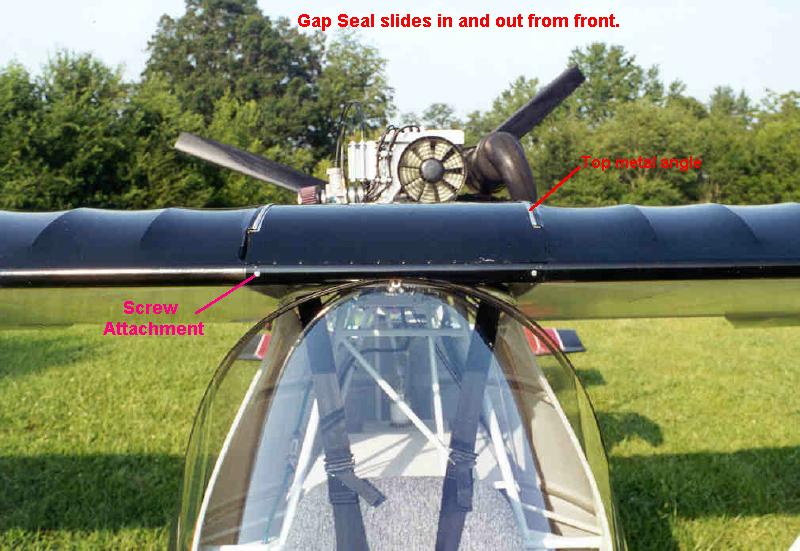

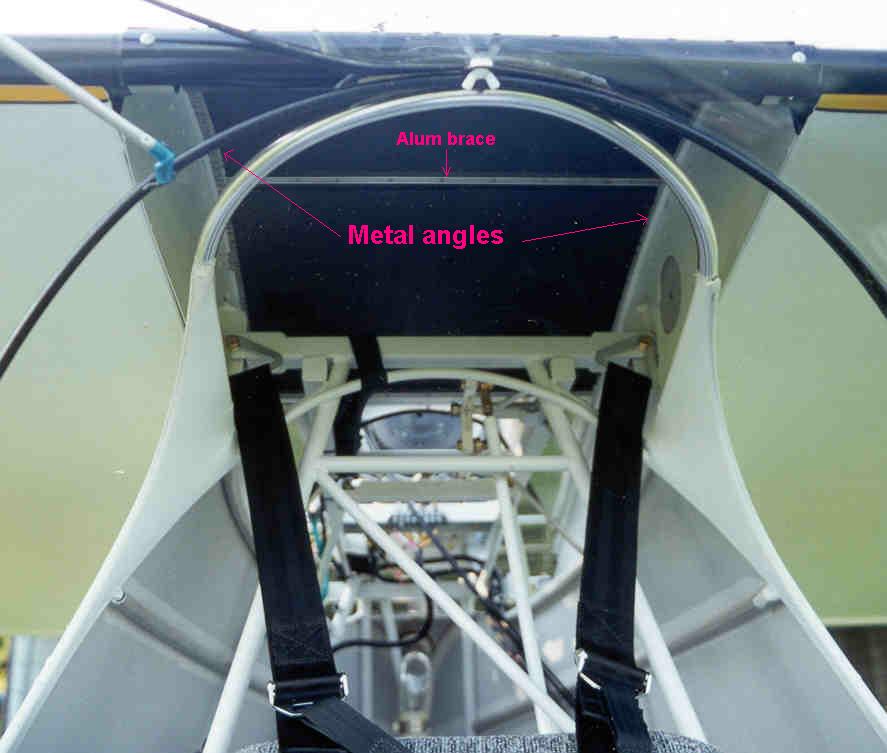

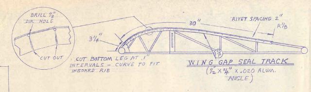

Subject: Gap Seal Description: Gap Seal - solid alum/slide converter
Gap-angles.jpg Photo Gapseal.jpg Photo GSeal1.jpg Photo Gseal2.jpg Photo
