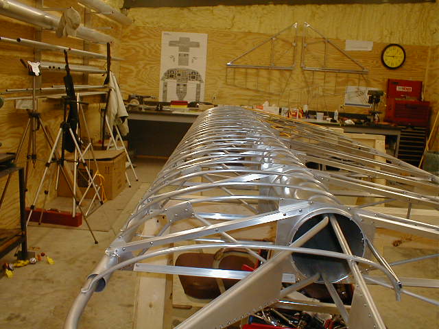

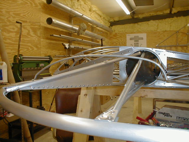

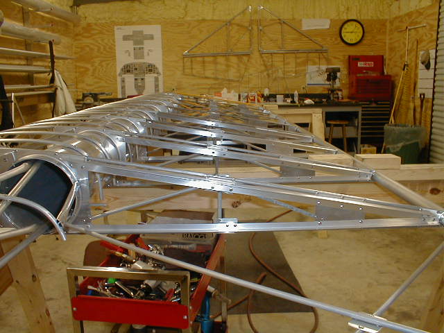

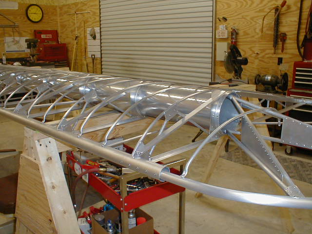

Subject: Wing Mods Description: Mods are made by adding 3/4" angle to all of the upper front main ribs and outer 4 of the rear. Then 1/2" angle on the bottom same way. Other mod in the extra 45 degree tip brace and webbing on both existing and added brace. Courtesy of John Hauck. Thanks John, now I can clip pine trees and only damage covering!
