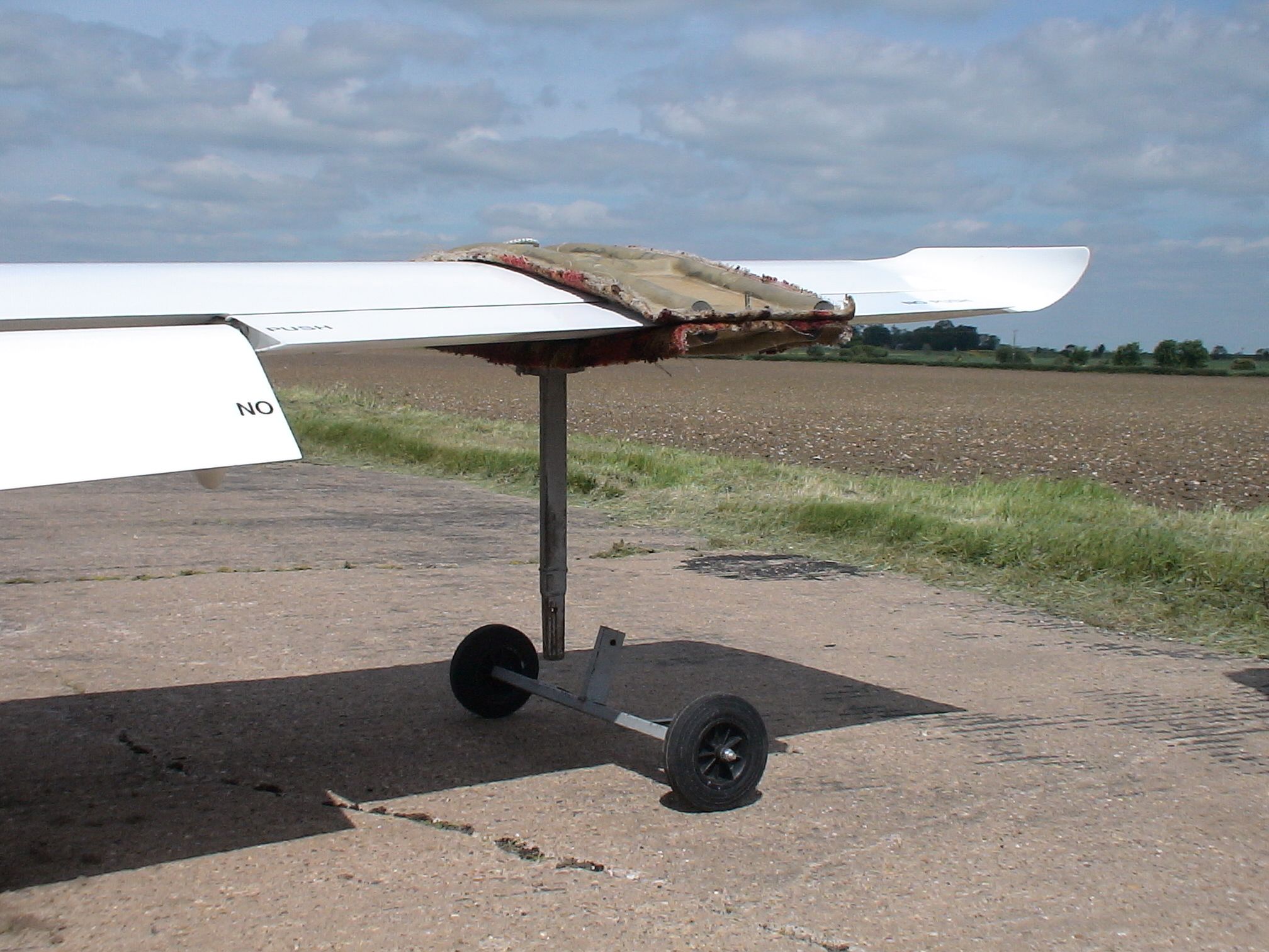

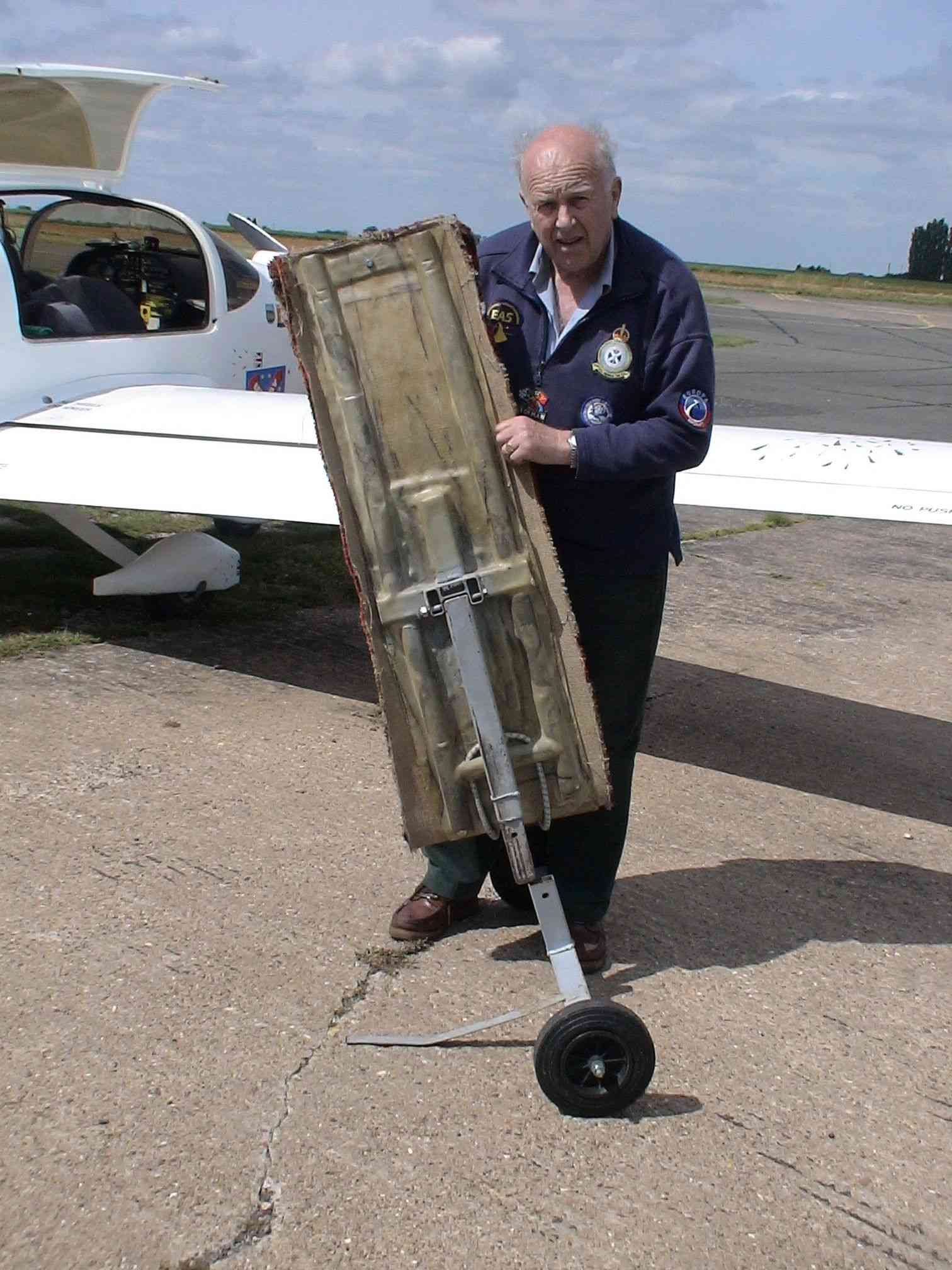

Subject: Self Rigging Dolly Description: Herewith a couple video clips for shareing on the Europa Forum which gets across the understanding of the single person rigging dolly.( the pivot point could do to be just 2" nearer the trailing edge for easier handling on any copies to be made) I will also forward under separate cover some slightly improved pictures of the single man rigging ramps extensions to the Europa spar sockets.
File: MOV00140.MPG MOV00140.MPG Video 1
File: MOV00141.MPG MOV00141.MPG Video 2 Single_Man_Rigging_Clamp_and_DollyDSC00145.jpg Shows clamp and dolly separate from the wing. Single_man_rigging_DSC00137.jpgUnder_wing_side_of_clamp.jpg Shows the under wing side of the clamp and the dolly wheels. Single_man_rigging_DSC00138.jpg_End_View_of_wing_in_clamp.jpg Shows the wing in the clamp and socket engaged in the wheels. Single_man_rigging_DSC00139.jpg_Upper_side_of_wing_in_clamp..jpg Shows the upper wing side of the clamp engaged in the wheels. Single_man_rigging_DSC00142.jpgSocket_Ramp_extensions.jpg Shows the extended ramps (under the redux!) to the port wing spar socket on the starboard side seat back. Single_man_rigging_DSC00143.jpgClamp_on_wing.jpg Shows the dolly clamped to the wing ready to be engaged with the socket on the wheels.
