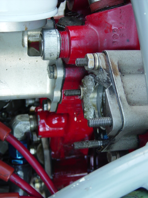

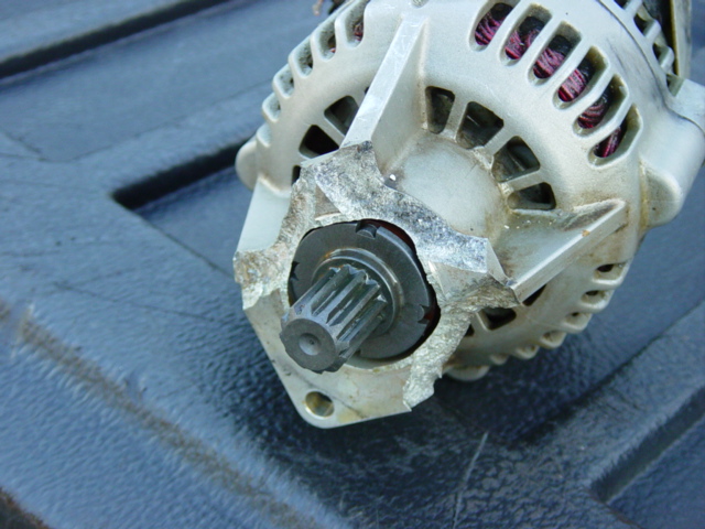

Subject: B&C Backup Alternator Failure Description: This B$C 20 amp backup alternator was mounted on the vac pump pad on a Lycoming parallel valve 540 engine. The engine is running 10:1 pistons and 2 electronic ignitions, and fuel injection. It is developing apx 300 hp. It is on a Berkut.
DSC01114.jpg Vacuum pump pad, and part of the casting DSC01122.jpg The alternator, and the rest of the casting.
