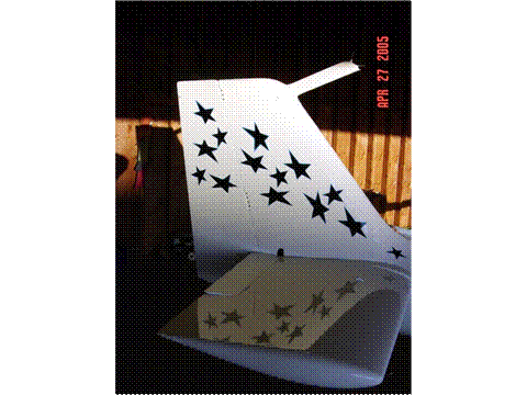

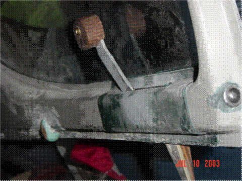

image002.gif Tri-gear, 914T, MG, Tail Probes - The three probes: Total Energy, Static, Pitot are elevated to avoid fuselage burble at slow speeds. image003.gif Tri-gear, 914T, MG, Wings, Aileron trim - The aileron trim and NavAid should combine with the GPS for easy cross-country flights. image004.gif Tri-gear, 914T, MG, Wing tip lights - Wingtip lights incorporate Whelen strobes and nav lites. They are detachable with three screws to be replaced with very small tips for low-drag, daylight flights. Also note the inclinometer: ailerons all sweep maximum travel with 1 ounce breakaway and ½ ounce slide pressure measured by a fish scale. image006.gif Tri-gear, 914T, MG, Wheel pants/Landing Lights - The gear legs are faired ala RV construction and contain adjustable landing lights. The filaments absorb the SkyMeadow sod strip without failure. Note leg spats for aerodynamics and ease of pant removal. image007.gif Tri-gear, 914T, MG, Canopy "egg" brace - The wooden egg nests into the fuselage for anti-bulge without any moving parts.
