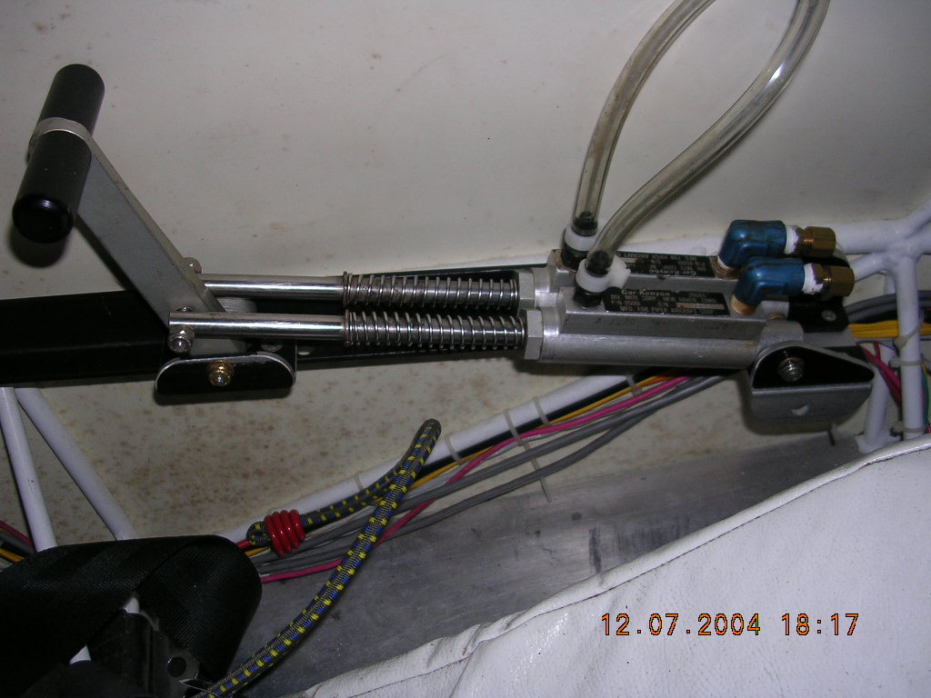

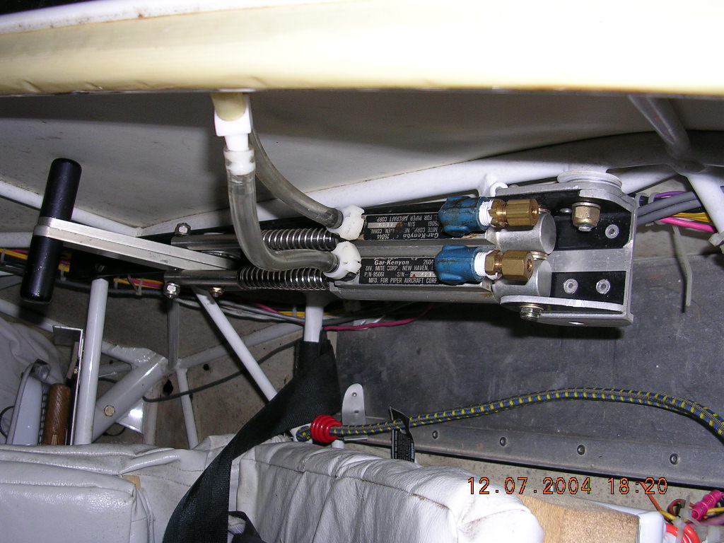

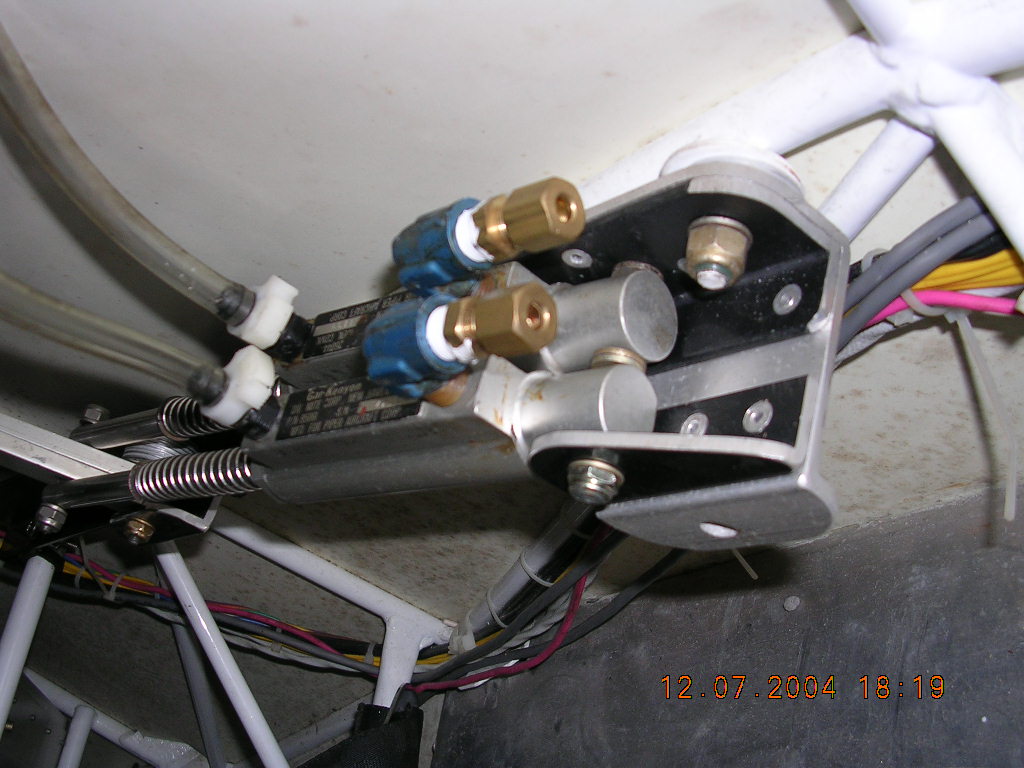

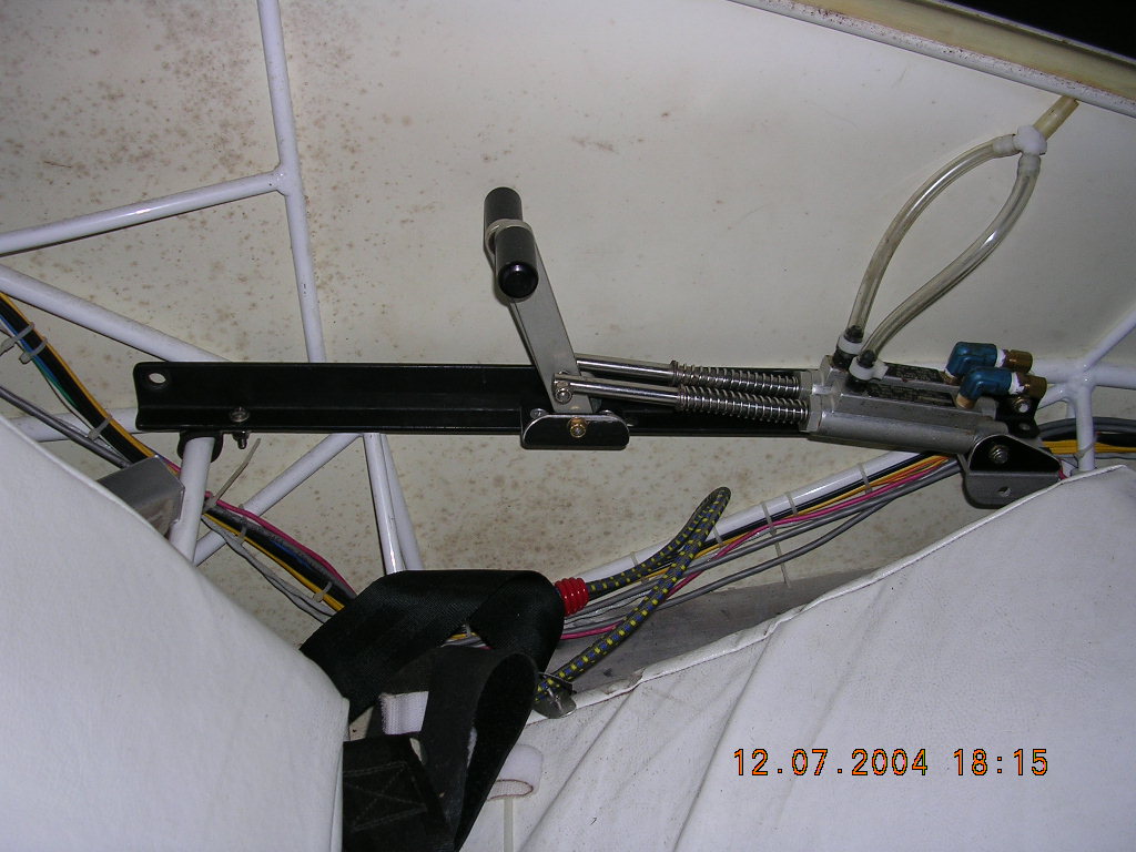

Subject: Pictures of Differential Braking System Description: These are some shots of the differential brake cylinders. They are mounted to the Throttle-Anchor bolt. As the throttle lever is removed & placed on the joystick. I left an ear on the assembly in case someone wanted to put a conventional throttle on the plane, or I might use it to relocate the flaperons via a control cable. The rear of the assembly is clamped onto the cage tube. The clear hoses on top are the oil reservoir. Cylinders are from Sun & Fun swap shop. ...Richard
DSCN0048.jpg Full View DSCN0050.jpg Close Up Side DSCN0052.jpg Close Up Front DSCN0053.jpg Close Up Top
