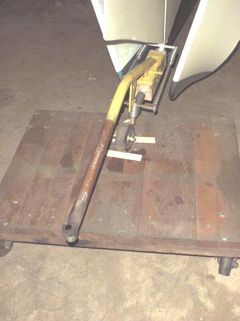

Subject: MkIII hitch Description: The hernia producing transport bar I welded up for short moves. The tailspring is sandwiched with a split wood collar encased in angle iron. Two bolts hold it together. The plate sticking down is still a work in progress.
