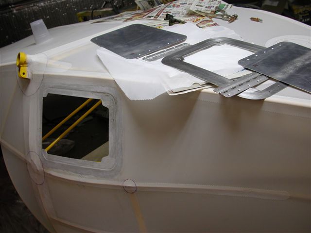

Subject: MkIIIex Baggage Door Description: I thought some of you might find my baggage doors interesting. On the bottom of the cage you can see all the parts, including the frame that is simply glued to the fabric and the opening is then cut out then the door is screwed and riveted to it. Cam locks will be used to hold the door shut. Notice how the frame is joggled so the door will be flush when it's closed.----here are some moor pics of the f&%&in air plane.
