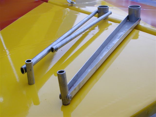

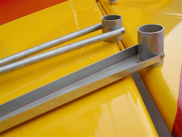

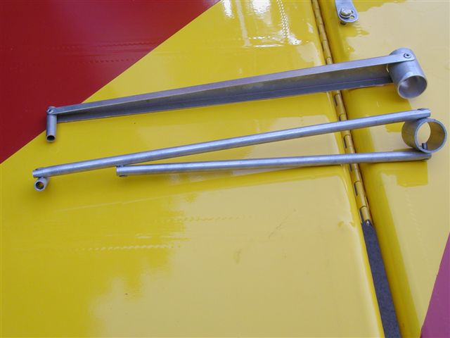

Subject: Holmer Bumps KOLB List Description: Here are the pictures of our ribs. Made like Cessna, piper ect. they seem to work ok for them. My two cents worth. The factory probably wants to keep the cost down, remember with a tapering surface you have to make a different part for each rib position except for the mirrored side. so you have to make two of each rib. pictured is a standard Holmer bump rib and a formed rib of 2024 structural aluminum not 6061 T6 more universal material.
