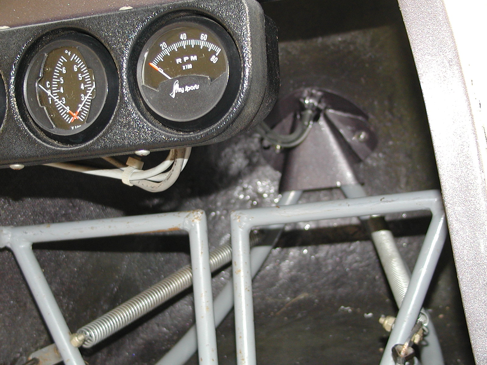

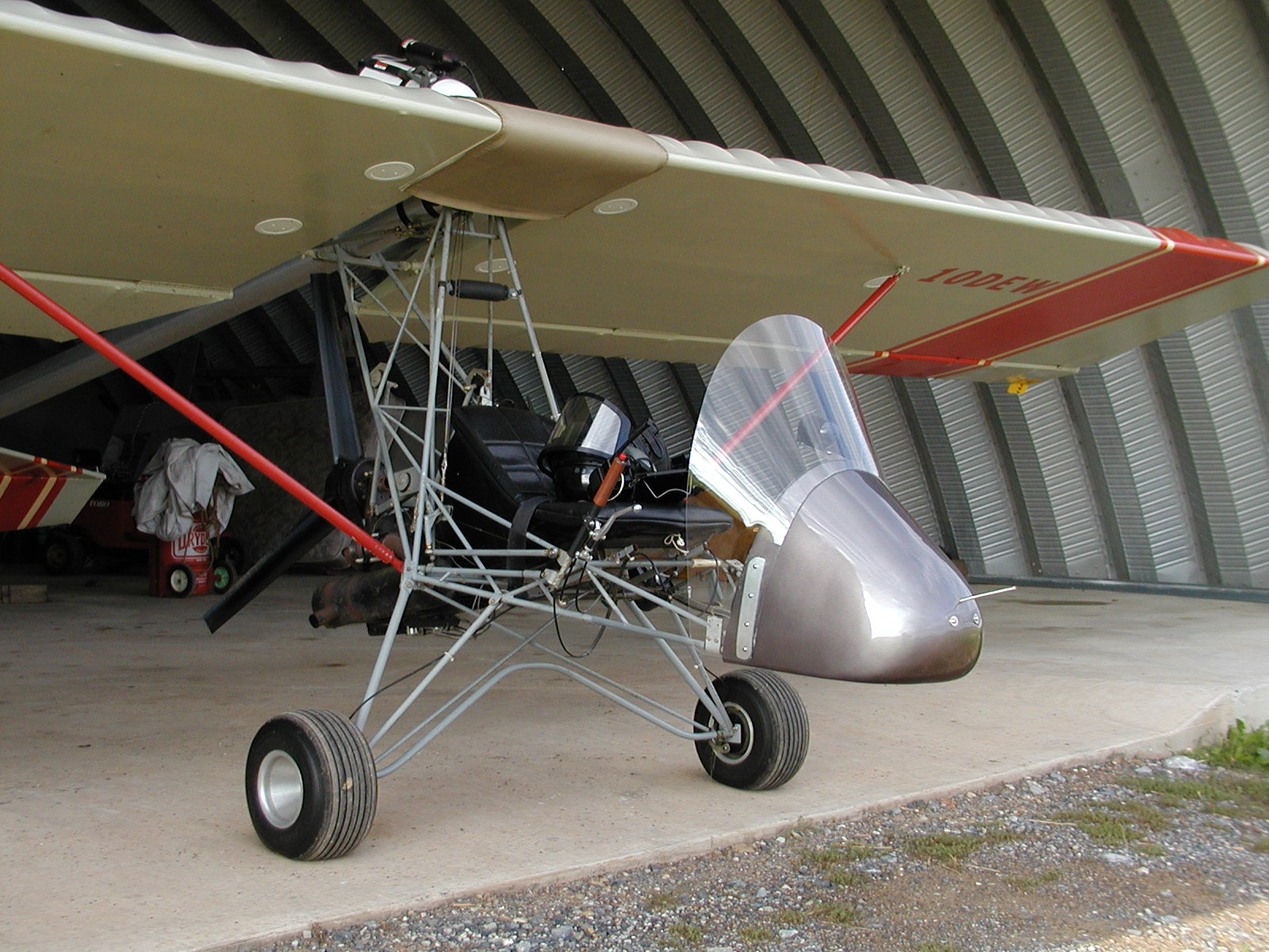

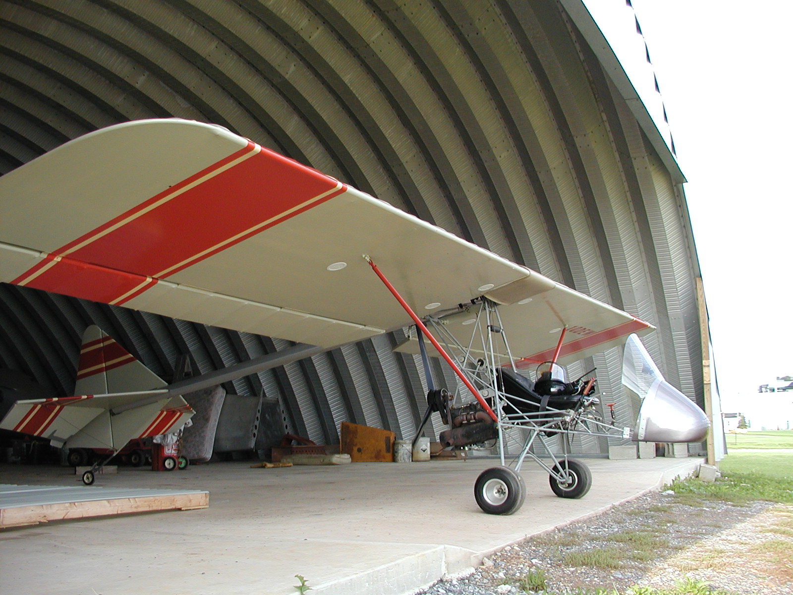

PIC00003.jpg The front is held on with a piece of aluminum formed around the point and held on the fiberglass with two bolts, The bottom has two bolts that come through the original heal plate. An aluminum stiffener was fiberglassed at the rear in a U shape about 8 inches up the sides. PIC00005.jpg Closer image of the nose cone and wind screen. PIC00009.jpg 1983 Ultrastar, Built from Plans in 1999. nose cone added in August of 2003, The addition of the nose cone and windshield changed the trim and the balance, luckily I could move the seat back enough to offset the center of gravity.
