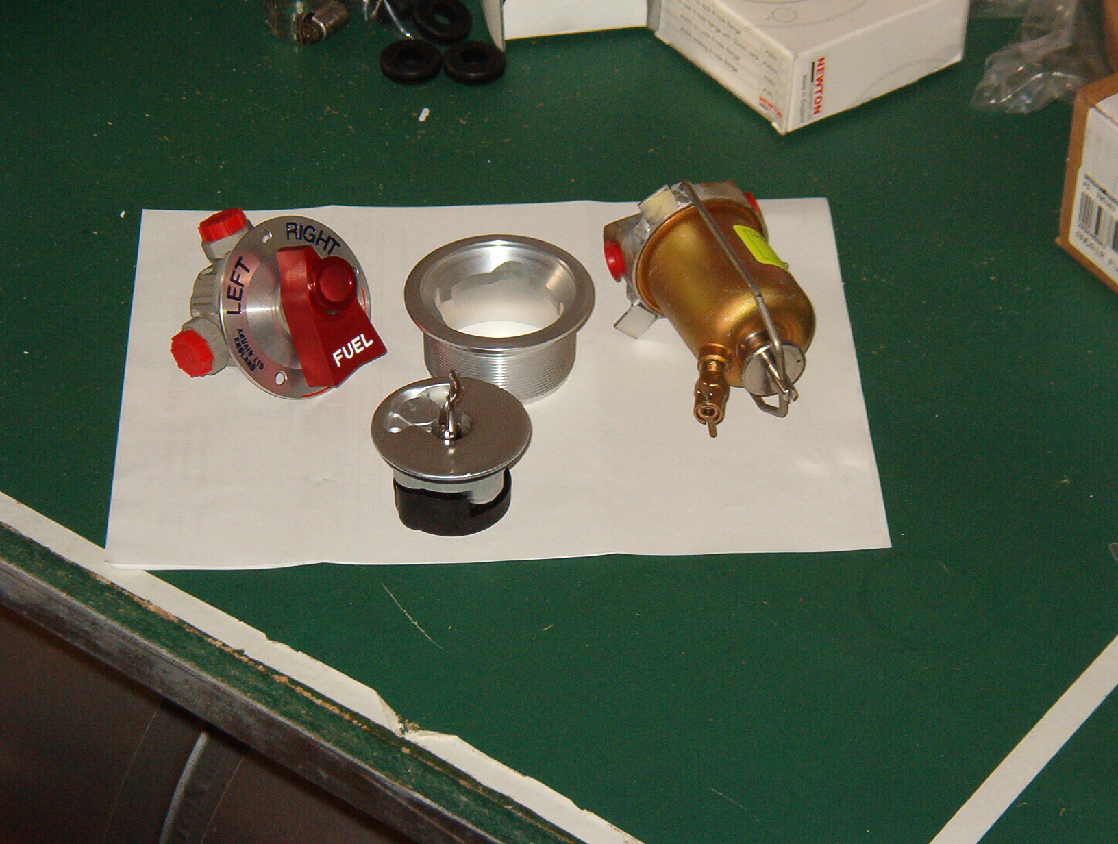

Posted: Fri Oct 17, 2008 4:20 pm Post subject: Photo of Extended Tank Range |
In attachement 6 photos of the tanks and all piece includes with the kit.
Christian

| Description: |
| Close look to Gaz Selector, Gaz cap and Gascolator. |
