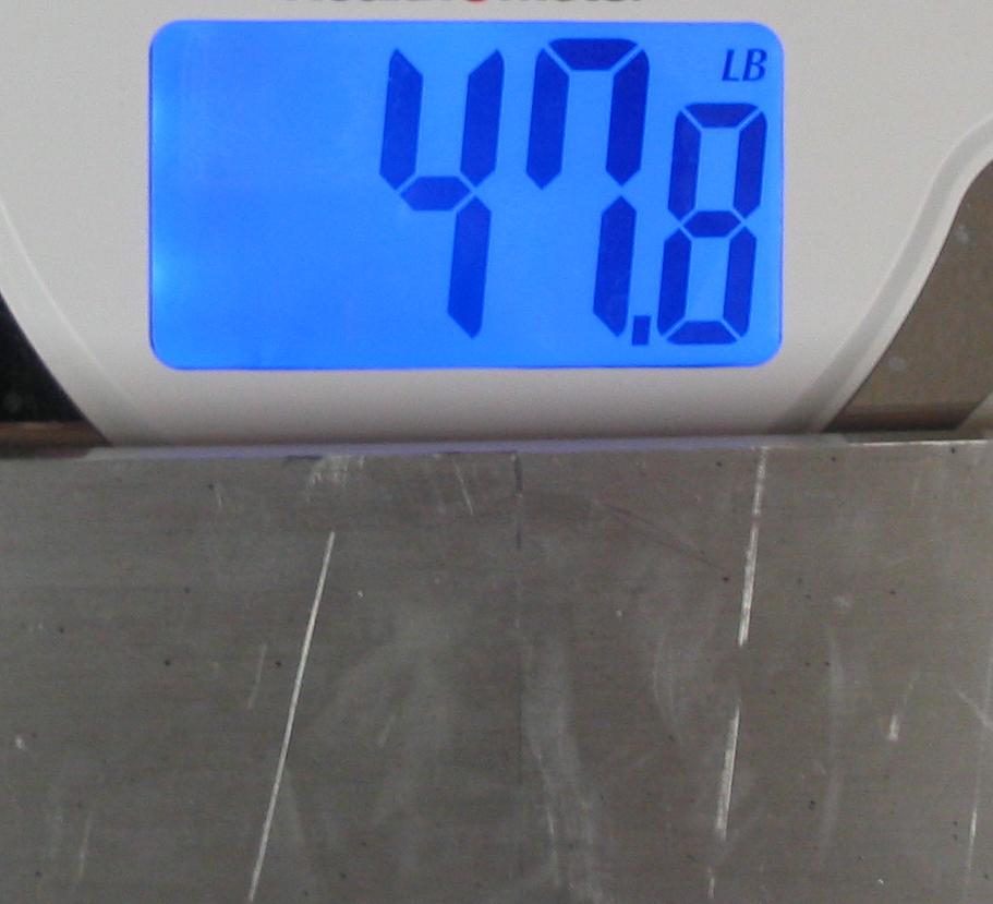

Posted: Tue Nov 18, 2008 2:39 pm Post subject: Re: All 601XL grounded in Netherlands |
Just put mine on the scale. With axles, but without wheels/tires, the big chunk of aluminum weights 47.8 lbs.
- Pat
- Pat
