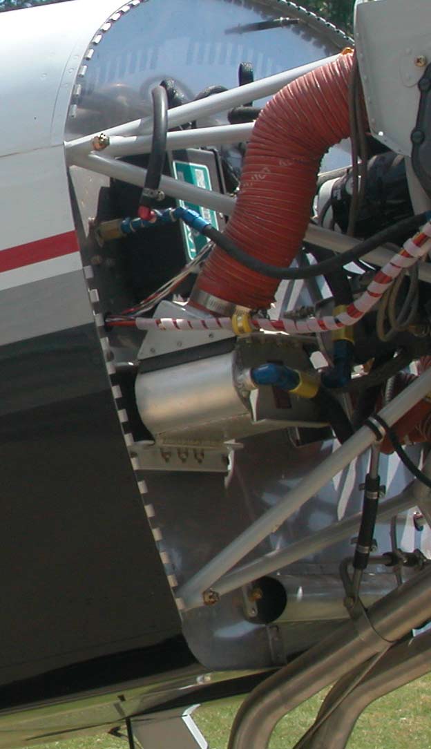

Jerry Grimmonpre'
Joined: 09 Jan 2006 Posts: 144 Location: Huntley, Illinois 60142
Posted: Thu Dec 18, 2008 3:48 pm Post subject: Oil Cooler Selection |
Check this out Dwight ... it was sent to me by this builder last year, he installed a SW ... just an idea for you. Jerry
