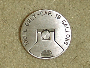

Ray.R.Doerr(at)sprint.com Guest
Posted: Fri Jan 20, 2006 6:42 am Post subject: Fuel Label / Placards |
You could do something like this instead. I did this on my
RV-9A and also had the N number on it in the middle.
Thank You
Ray Doerr
40250
