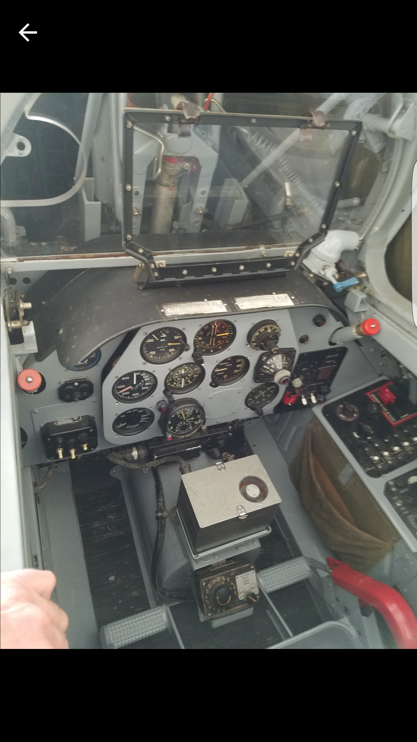

PostPosted: Mon Jun 20, 2016 1:18 pm    Post subject: Attitude indicator Reply with quote
The original location for the attitude gyro is above the rear floor in a
dome. If rear controls have been added it's most likely moved to rear side
On June 20, 2016 10:03:28 PM Delfindriver <L29delfin(at)yahoo.com> wrote:

 Filesize:  2.92 MB
 Viewed:  23920 Time(s)

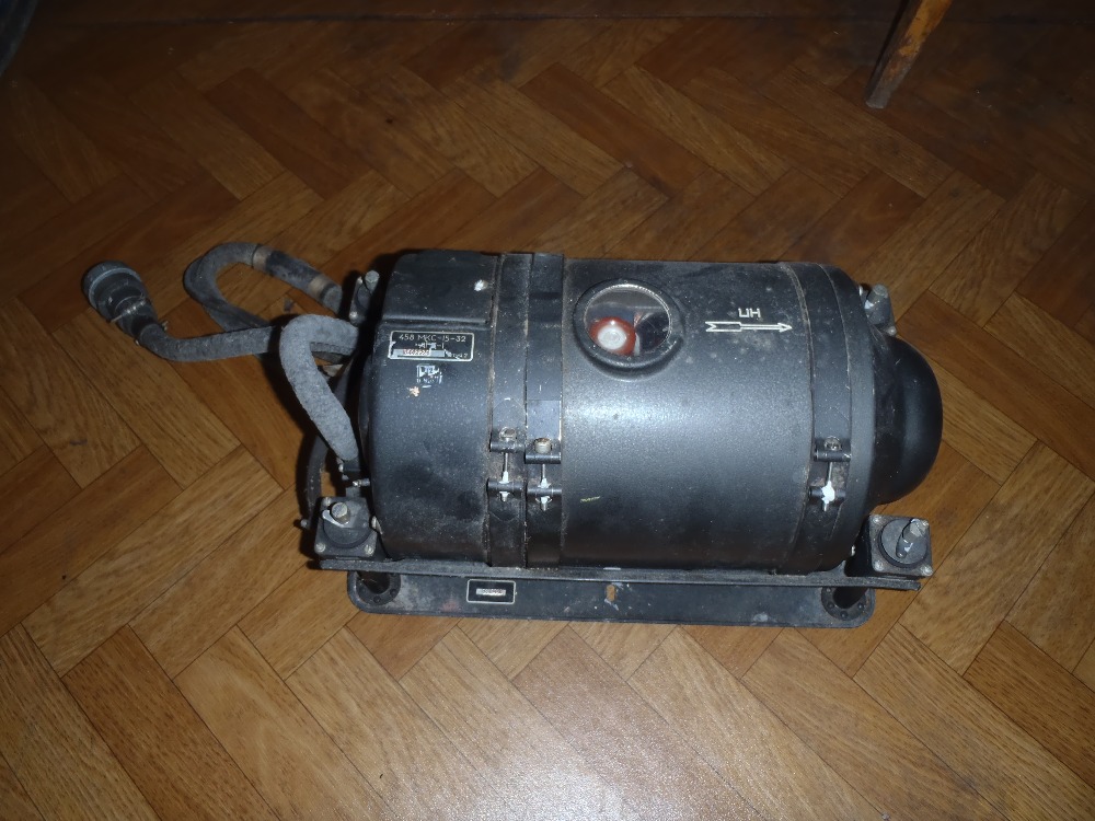

PostPosted: Mon Jun 20, 2016 5:31 pm    Post subject: Attitude indicator Reply with quote
It's about the size of a watermelon. It has a glass bubble site on top. U could Jack it up and level the airplane, then center the bubble. However, 35 years of Acro may be taking its toll. The "R" models didn't do much maneuvering, but they are still aging. Sometimes I walk with a 5 degree crab. I'm old.

So, I finally have time to look into this, here is what I found;
Is this the gyro for the Attitude indicator?

yes

The picture is not from my airplane, but from a guy who has one for sale. I would like to test mine before I go out and change it.
It there a specific method to remove it?
Any particulars to pay attention to?
Any specific Voo-Doo dance I must do to not jinks it?

Since u r a small guy just getting it out will be fun.
Remove rear seat, which requires removing rear canopy....
