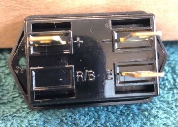

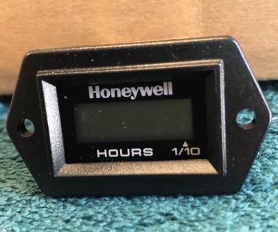

I'm currently researching ways to activate my hobbs meter. Probably not
a big deal, but I would prefer something other than using a feed from
the oil pressure. Much like the electrical failure points discussed on this
list, I see the extra oil fittings as possible failure points. I know that's
primarily used but was wondering with modern avionics could there be another way to activate the hobbs?
Also, are you using a analog or LCD meter? I originally planned the
Honeywell, 2 pin LCD unit. However, I realized the unit would only display
the digits when it was activated by oil pressure or other device used to
complete the circuit. I would like to see the digits when battery is
switched on.

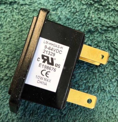

I switched to the 3 pin LCD unit. Honeywell LM-HH3AS-H21. The pins are
positive, negative and enable. https://www.digikey.com/en/products/detail/honeywell-sensing-and-productivity-solutions/LM-HH3AS-H21/5069695
It will be powered off the main power bus when battery is switched on.
I now just need to figure out how to power the enable portion..other
than oil pressure. I found an activation switch that uses pitot pressure,
but it does not activate until 27 mph. Don't love that either:)
https://www.edmo.com/product/AEROMETER/hourmeter-airspeed-switch-stc-aerometer
Any ideas from the group?

I'm using a 3 wire (+,-, and enable pins) LCD meter and
would like the numbers to display when battery is
switched on, but not start the timer. I'm having trouble
finding a wire diagram for my unit, but guess the enable
pin goes to ground. I will need to do some more
homework to see if I can make the options you mentioned work.
I'm using garmin stuff so possibly there's a way to
make either option 1 or 2 above work. If not, I may have to resort back
to using the oil pressure switch.

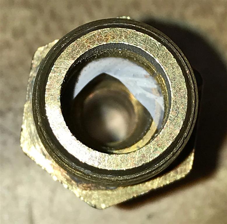

The concern with tape is that even if it's applied to the threads properly, upon removal of the device some of it can remain in the female threads, and get pushed into the passageway when the device is re-installed.
I don't know whether that's a valid concern, but I use teflon dope so I don't have to find out. Wink

I found this, and several other fittings like it, when disassembling the header tank plumbing on my second-hand Kitfox project. The first builder had used Teflon tape in their assembly without proper care.

Bob,
It's a Honeywell LM-HH3AS-H21. The only document I have been able
to find is the data sheet on this page.
My current electrical diagram has the unit powered off the Main Power
Bus so it should illuminate the LCD numbers when the battery is
switched on. I need to find a home for wire from the enable pin.
My planned ignition system is a SureFly on the left and a Slick mag
on the right. I'm working on a post for the list for a small can of worms
I've opened with that system.
Shawn

Mudfly wrote:
I'm having trouble finding a wire diagram for my unit, but guess the enable pin goes to ground.
Here are the installation instructions for the unit you mentioned. Wiring data is on the first page. The enable pin is active high.
https://tinyurl.com/386autu8+

looked all over the data sheet and couldn't
find a callout for enable pin functionality . . .
for a Honeywell product, I find that surprising.
Anywho, I suppose your assertion of active
pull-down is correct.
Actually, no big deal. Given that you have
a magneto, let's consider an ignition activity
detector tie to the Slick p-lead.
I did a sketch for a reader about a quarter
century back. I'll see if I can dig it up
or duplicate it. Probably have all the needed
parts to dedicate to the cause. Watch
this space.

PostPosted: Wed Apr 26, 2023 8:59 am    Post subject: Which Oil Pressure Switch? Reply with quote
--> AeroElectric-List message posted by: "Mudfly" <shawntedwards(at)hotmail.com>
[quote="nuckolls.bob(at)aeroelect"]At 07:56 AM 4/21/2023, you wrote:
[quote]--> AeroElectric-List message posted by: "Mudfly"
Shawn,
Could you set this hourmeter up on the bench
and measure the current draw on the enable
pin in the pull-up configuration? I think
I have a simple solution using p-lead
signal from a mag to drive the enable pin
but having that current value would facilitate
optimization of the components.
