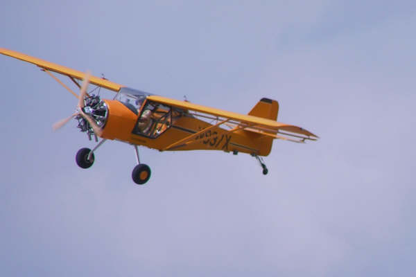

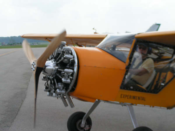

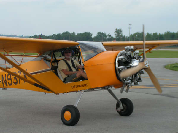

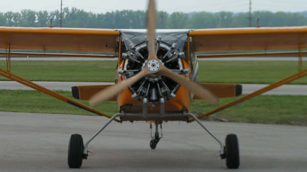

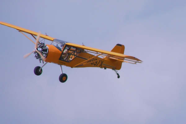

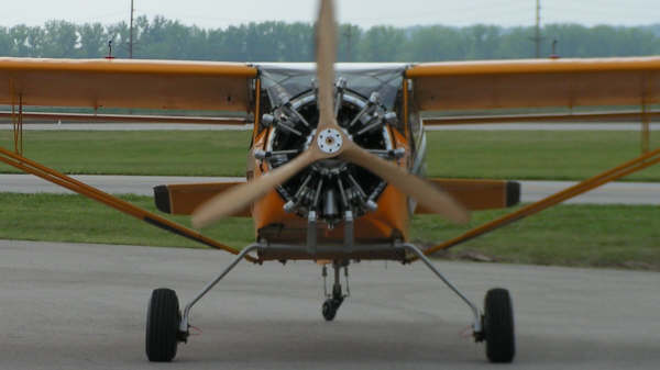

I recently installed a Rotec R-2800 7 cylinder radial engine in my Classic 4 Speedster. Runs good. John Murphy , St. Louis

PostPosted: Wed Jun 06, 2007 9:13 pm    Post subject: Engines and experimentation Reply with quote
Marco + Lowell ; I do not have good numbers yet but should be good. Fuel burn is supposed to be about 5 GPH.Engine is heavy also had to add ballast to the tail . Rotec website is
www.rotecradialengines.com There are a few other Kitfoxs shown there. Probably not the ideal engine for the airplane but interesting .Call in the evening if anyone would like to discuss it. John Murphy 636-532-0479
