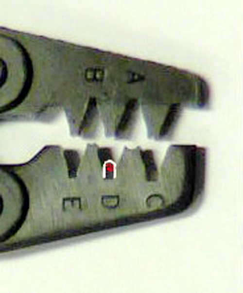

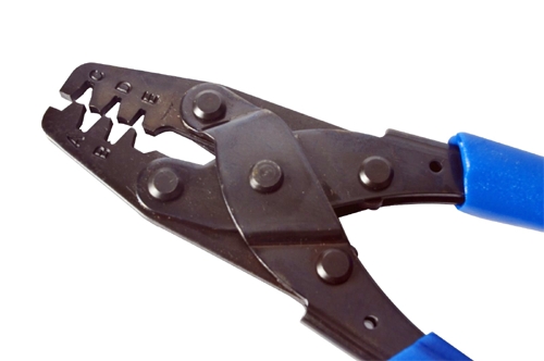

[img]cid:7.1.0.9.0.20160508170431.020de450(at)aeroelectric.com.0[/img]
My favorite tool has no 'settings'. There
are three b-crimp pockets which are generally
adequate for terminals accepting wires from
14 AWG to 22 AWG.
 Filesize:  56.58 KB
 Viewed:  7032 Time(s)

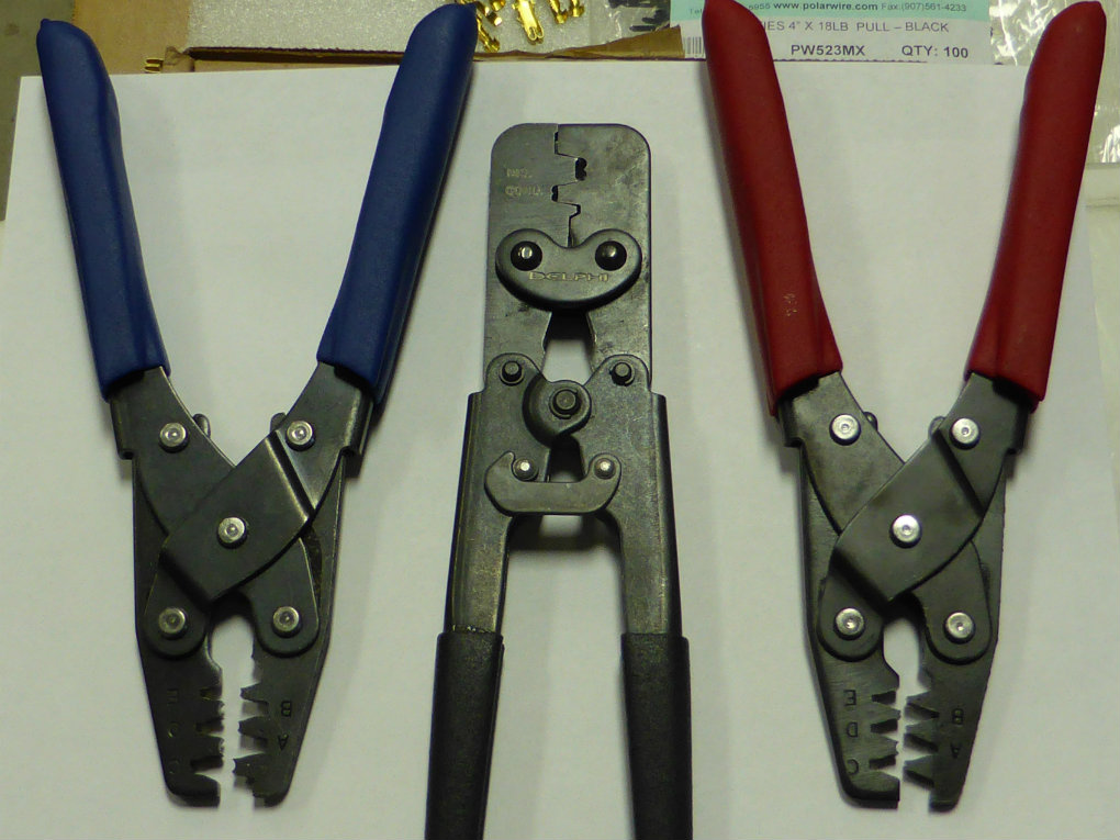

That looks similar to what I have tried. Attached is a photo showing the three I have used so far. Two fairly inexpensive and one fairly expensive.

PostPosted: Sun May 08, 2016 3:42 pm    Post subject: finding the correct crimper Reply with quote
The one on the right should work. Are you
sure the terminal wasn't rolling over in
the die before the punch starts to curl
the ends over onto the wires?
The "D" die should do the 18-20 AWG terminals.
Use the jaw-tips to partially close the
wire grips so that they are parallel to each
other. Then position in the die as shown, bring
the punch down on it with just enough force
to grip it. Slip the strands into the grip
region and put the mash on it. Use as much
hand-pressure as you can muster.
Pre-positioning as suggested should keep
the terminal from rolling as the punch
pushes it into the die.
[img]cid:7.1.0.9.0.20160508183214.04f87e60(at)aeroelectric.com.1[/img]
The rachet handled tool is undoubtedly set
up for a certain line of terminals and mating
wires. It will have a fixed crimp height, thus
limited in the range of wires/terminals.
The tool above stops reducing crimp height only
after you run out of snort, hence more accommodating
of variability in materials.
 Filesize:  129.48 KB

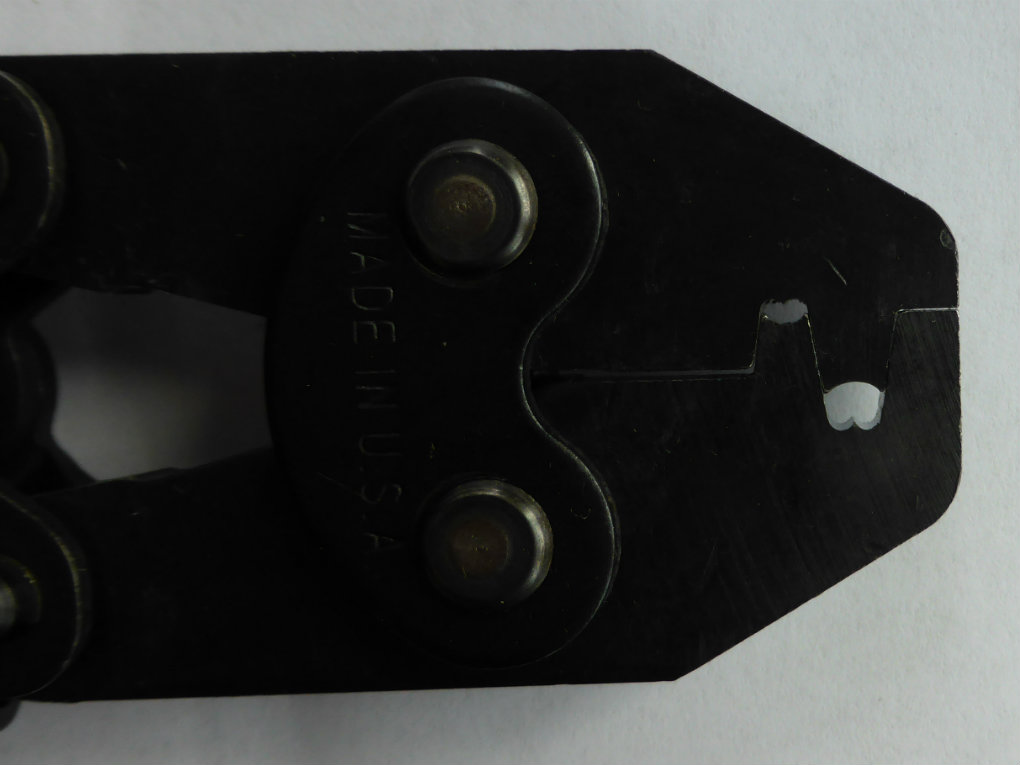

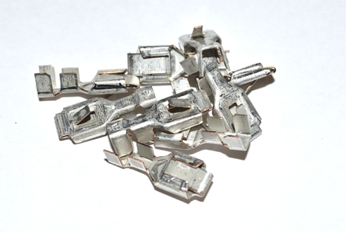

Just guessing but the middle tool seems
to be for the Delphi 56 series terminals
and is probably an earlier version of this
tool.
[img]cid:7.1.0.9.0.20160508185158.021be978(at)aeroelectric.com.0[/img]
for these terminals.
[img]cid:7.1.0.9.0.20160508185158.021be978(at)aeroelectric.com.1[/img]
If you turn your tool over, are the punch/die
pairs a different size? That tool looks like
it does wire and insulation in a single stroke.
Those tools will generally have smaller cross-
sections on the wire grip side . . . a bit
larger on the insulation side.
Definitely problematic for the task at hand . . .

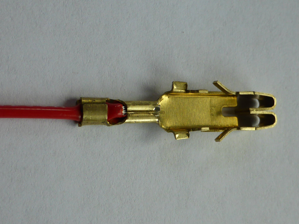

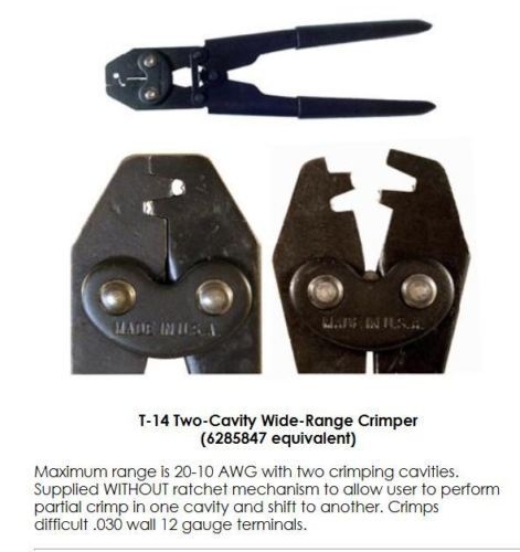

The new crimper worked perfectly, first time. Data on crimper: Purchased from crimpsupply.com, SKU 37A11001, Metri-Pack/56 Series/Pack-Con Crimping Tool #6285847. This crimper does not have a slot for the insulation crimp, but one of my other crimpers does. I probably got a little aggressive with the insulation crimp, will correct that on futures. The main thing is that the wire crimp worked perfectly, just as it should, giving a strong, tight good looking crimp. Pictures attached.
