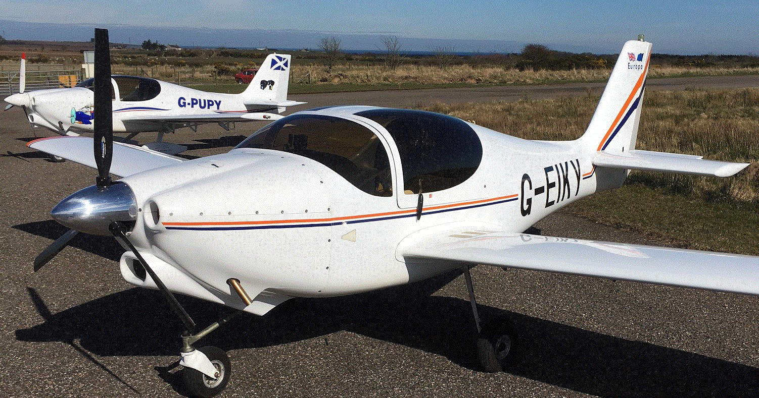

PostPosted: Sun Mar 26, 2017 10:57 am    Post subject: Re: 1.5 degrees right? Reply with quote
Picture as requested
 Filesize:  605.74 KB
 Viewed:  4869 Time(s)
