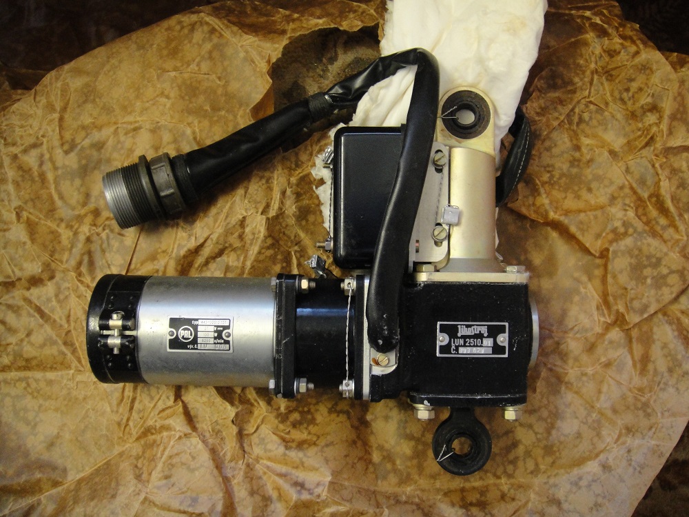

Here it is

It happened I crossed over the L-29 Stabilizer Trim mechanism new surplus oversea for a decent price. While I have one here in Calgary I would sell mine (new surplus) to put couple hundred bucks toward my fly tickets this July-August.
I would let it go for 870US plus shipment cost around 50US to USA (will confirm with UPS at particular address) from Calgary Canada . Payment could be thru PayPal.
If I don’t buy that one oversea then it’s lost.
Pictures you can see at top.
