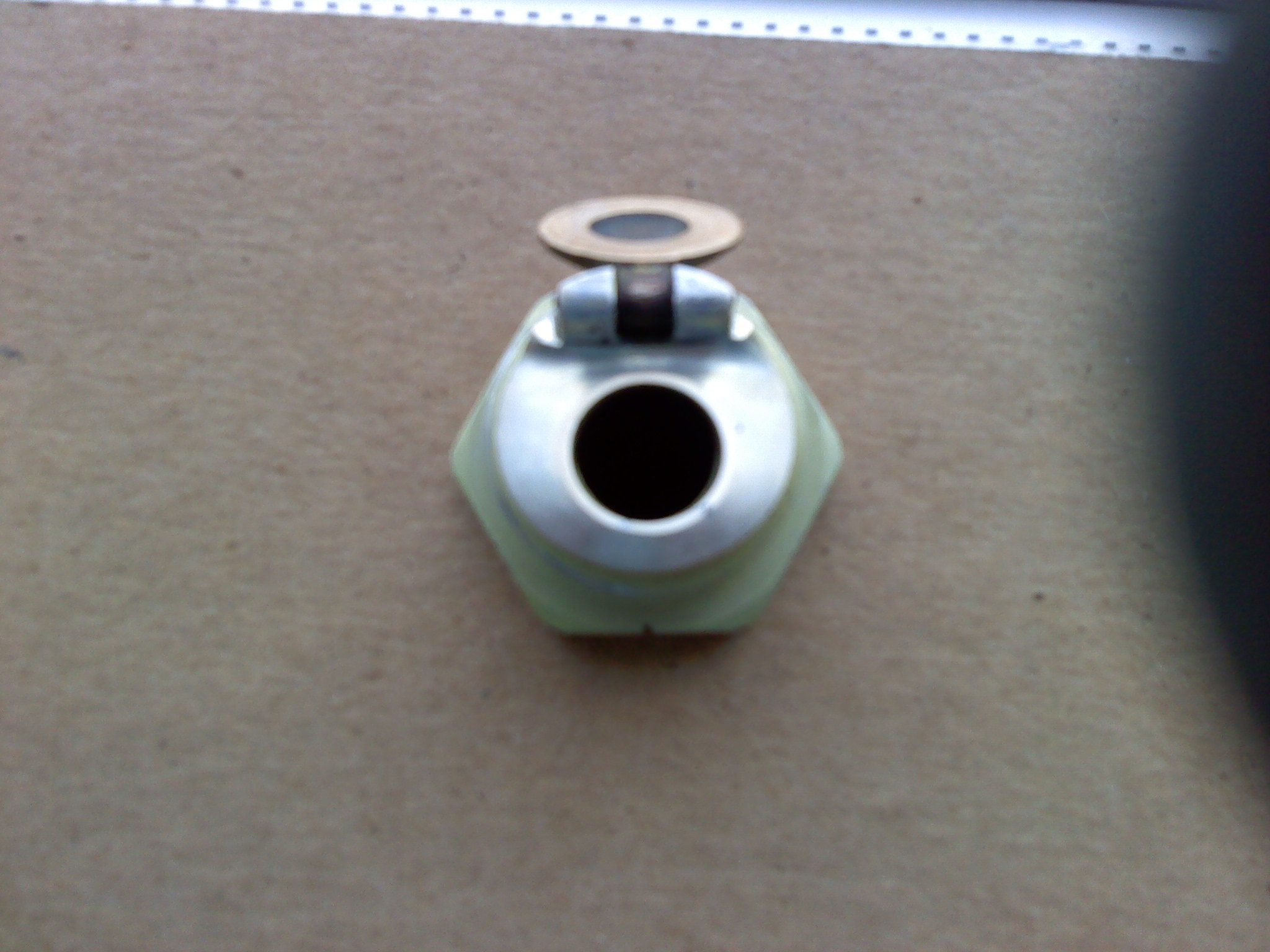

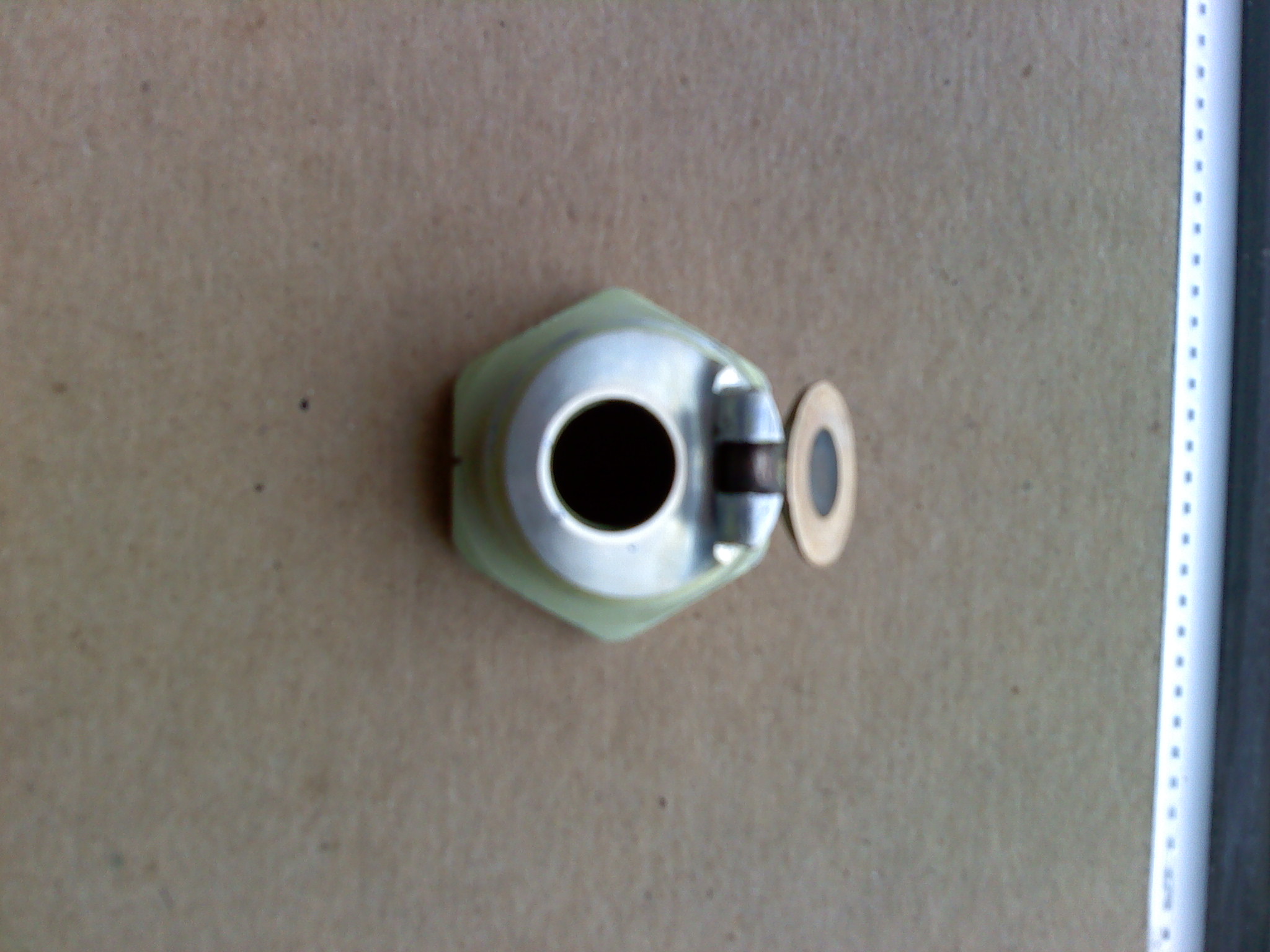

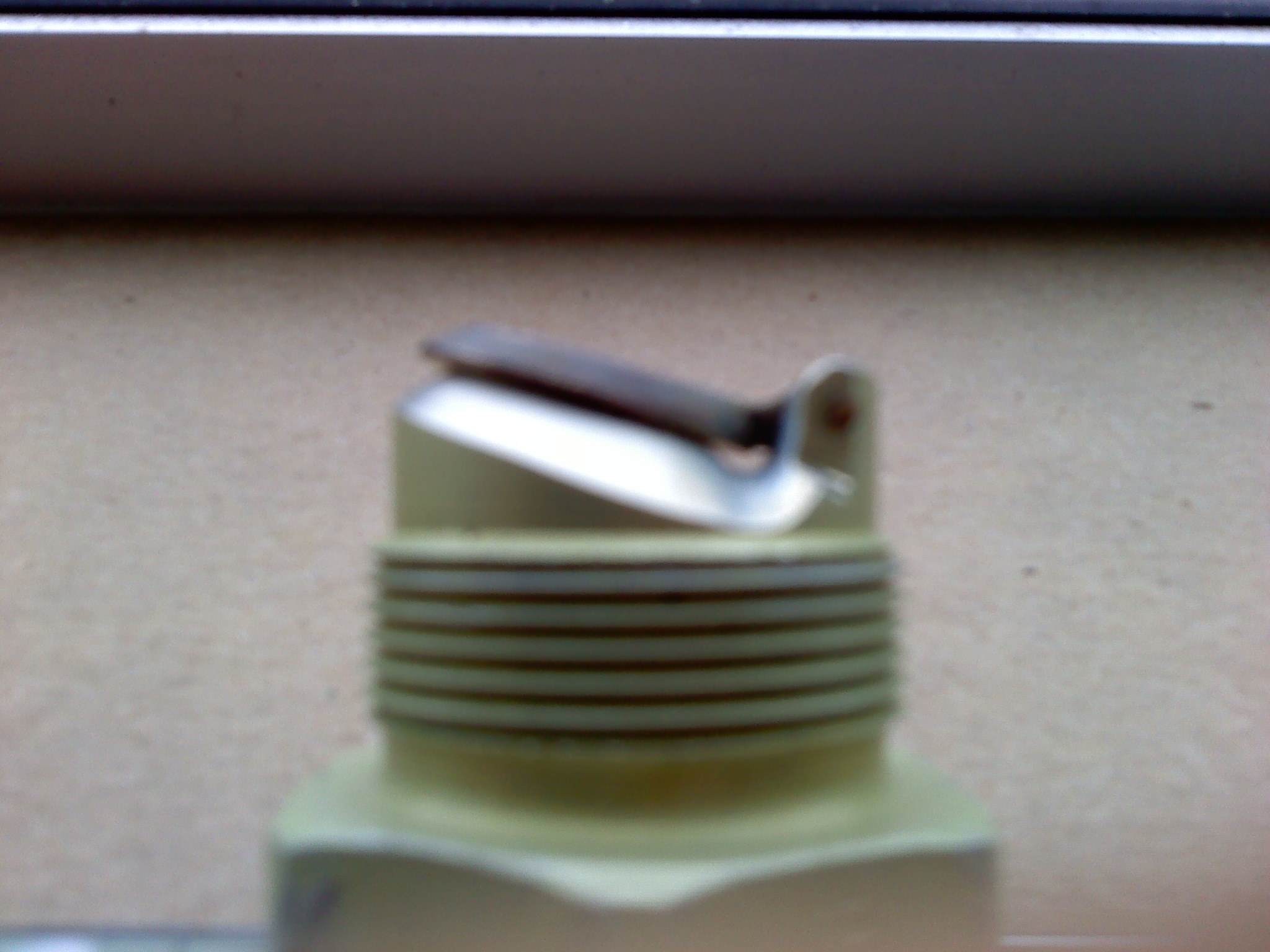

So; I have modified the valves in mine by removing valve seat material to
reduce the surface contact area from 100% to a near line contact. (actually,
since this is a hand filing operation) about a 0.020' to 0.030" contact
band. This allows the normal closing pressure to also react on the opening
side of the flapper resulting in a much closer balance between opening and
closing forces. See attached photos.

 Filesize:  402.08 KB
 Viewed:  6775 Time(s)
 Filesize:  388.89 KB
 Filesize:  389.02 KB

On flapper valves; There are 3 of these in the CJ. One is mounted in the
line from the header tank to the fuel pump for the sole purpose
of preventing back flow of wobble pump fuel which would otherwise just
re-circulate through the wobble pump. It is subject to substantial opening
pressure from the wobble pump. Even Chinese fuel glue could not keep it
closed. An excellent design for the application.
The other two are identical but are used in an application that requires a
slightly different design which moves with fuel flow at minimal differential
pressure. These are designed to require a significantly higher differential pressure to open (significantly here is a relative term, if one could measure the pressures involved it would likely be in milligrams/sq. cm. ). This is evident on inspection:- the area of valve opening surface is about 1/4 that of the surface holding it closed.
In theory, with perfect trim and absolutely no turbulence whatsoever this valve would require one full and one empty tank to open.
So; I have modified the valves in mine by removing valve seat material to reduce the surface contact area from 100% to a near line contact. (actually, since this is a hand filing operation) about a 0.020' to 0.030" contact band. This allows the normal closing pressure to also react on the opening side of the flapper resulting in a much closer balance between opening and closing forces. See attached photos.
I normally never see a fuel imbalance in excess of 2 to 4 lts. except when I try to do good slow (or point) rolls. In this case the valve flappers are are doing just that, flapping! After a few I see imbalance up to 15 lts. or so which returns to normal in a few minutes of level flight.
The valves alone are not the whole problem, I can not stress how important the condition of the fuel and vent lines are. Both damage, internal contamination and leakage are critical. I have spent days during CJ restorations with a hose, hot water, dish washer soap and shop air getting crap out of the lines. If you are going to do this be sure both ends of all lines are disconnected. You don't want to blow up the the mains or header tank in the process.
I had a good example of what a minor discrepancy can do to this fuel system. A few years back on about 1 hr. flight home checked fuel gauges and shocked to see a 20 + lt. imbalance. Checking the vent system I found one connector hose in the RH wing joint area had slipped off! (I had used all new hose but no clamps thinking they were tight enough). Dumb! But this relatively small vent pressure change made a huge difference to the entire fuel system.
These valves (In Western terms normally called a vent valve) MUST be mounted with the flapper hinge at the top! This requirement is a problem for the Chinese valve as mounted in the header tank since it is threaded into a welded fitting on the tank wall with a sealing washer.
So; Three things have have to come together at precisely the same time and place. The valve is at the top, the torque is correct and the sealing washer is exactly the right thickness. This of course is mission impossible.
