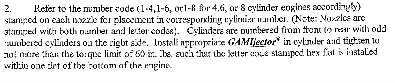

Sorry to be too lazy to go pull the cowl to check, but does anyone know if the same injector marking rules apply to the GAMI injectors?  Have been happily flying behind a set of them for more than a decade and never really thought about clocking them during reinstall after cleaning (or remember reading GAMI instructions that said to do that).

I don't know...However, since they are just injectors with the restrictor more precisely drilled, I expect they would be the same.

Dan,
This should help you out. Paragraph #2:
[url=https://gami.com/gamijectors/installation/GAMI IP-98-001 Rev B Lyc GL10.pdf]https://gami.com/gamijectors/installation/GAMI%20IP-98-001%20Rev%20B%20Lyc%20GL10.pdf[/url]
[img]cid:EB809DEF-DBCC-4749-A943-94F30665C4DC(at)localdomain[/img]

Just what I needed, Lenny.  Thanks!
