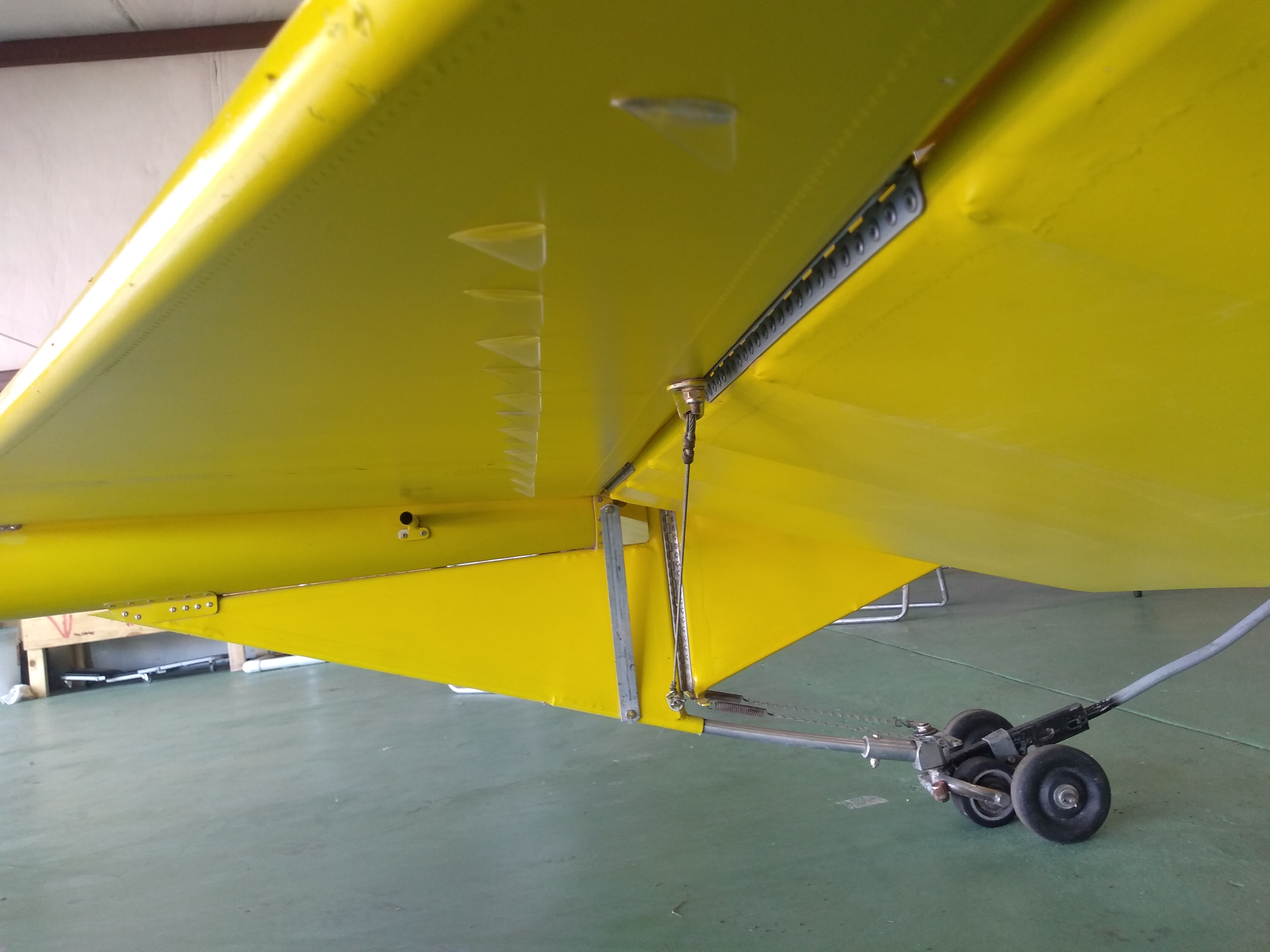

The link that I sent you will slip onto your tail wheel tube. The
braces for the tail wheel are both sides, using the existing bolts and
holes already in the tail wheel tube, Just drill holes in the collar
in between existing holes.

PostPosted: Tue Dec 20, 2022 2:40 pm    Post subject: Firestar KXP Reply with quote
This is not the best picture,  but look at the front of the tail wheel attachment rod,,  up to the ring that attaches the back of the empanage to the tail boom....
I have a 1/4 by 3/4 flat bar on both sides.   They triangulate the lower vertical stabilizer to the tail boom and eliminate most of the side load.
___Boyd_________________
 looks like it could fold over if there was enough side loading.
anyone have pictures of their tailwheel attachment point to see if my setup is wrong or how to reinforce it.

neilsenrm(at)gmail.com
PostPosted: Tue Dec 20, 2022 2:43 pm    Post subject: Firestar KXP Reply with quote
Jeremy
I too added the tail wheel brace to my plane. I have seen damage from others and felt it was needed. I used two pieces of 1/8 by one inch aluminum hardware stock to brace the tail wheel. Yes, both sides.
I also changed the tail wheel from the pizza cutter to Kolb supplied locking full swivel unit. Seems like Brian had a lighter unit he developed. I have the older style which required modifications to work properly. First drilled holes in the tail wheel bellcrank inboard/closer to the pivot so that the tail wheel would rotate enough at full rudder movement so the tail wheel would unlock. Then I added compression springs so that I could taxi in a cross wind without unintended tail wheel unlocking.
