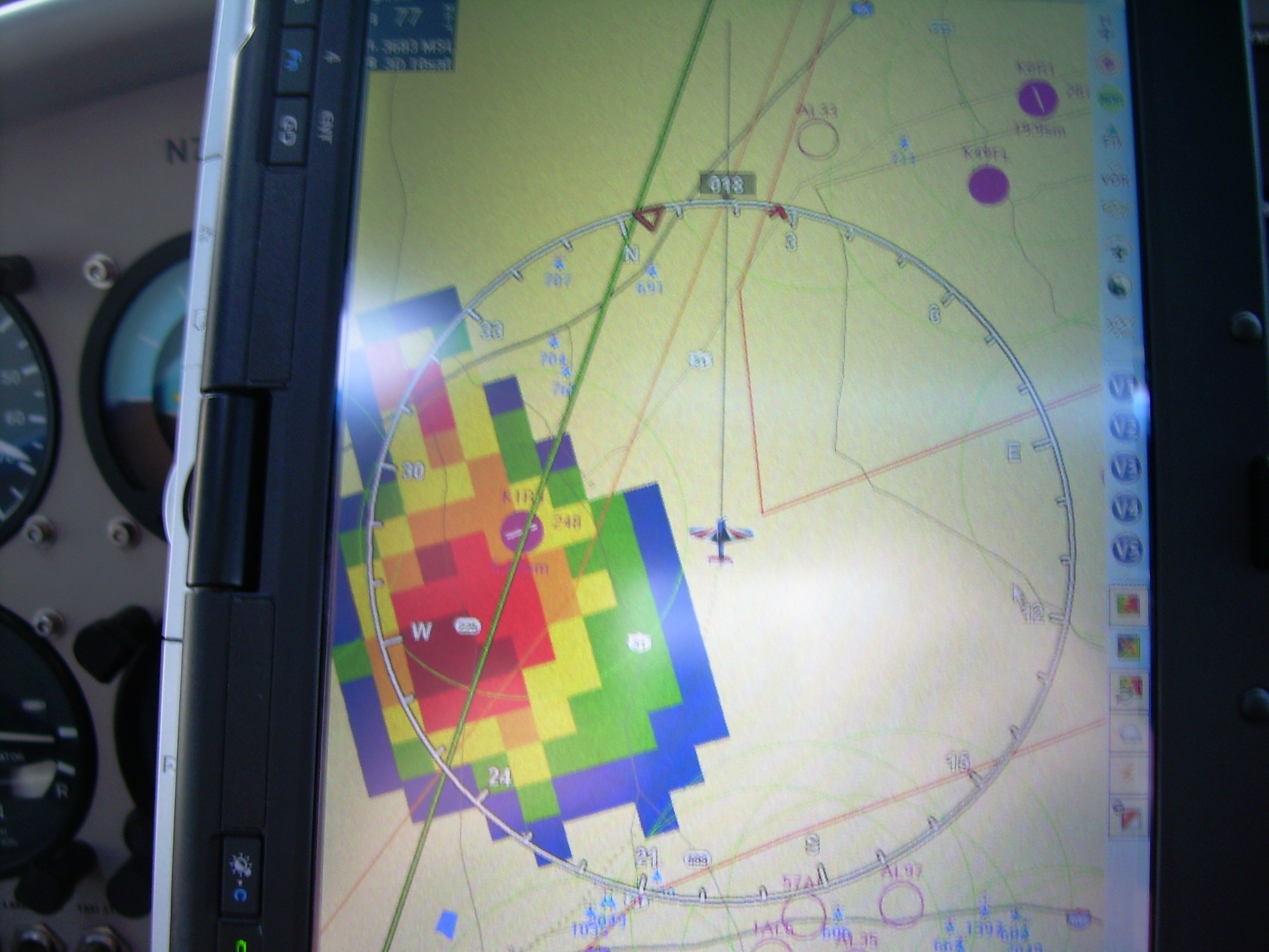

I don't have any real issues with flying in rain...as long as I can see through it! My Prince Prop is wood core with Kevlar coating and leading edge protection. This past Saturday I got sort of trapped and had to fly about 15 miles in a pouring rain...trying to beat the level 5 thunderstorm that was quickly approaching our airport.
I carry a short roll of poly tape on the plane. If I know I will be encountering rain, I will apply equal strips to each blade prior to take off...just for the extra protection. The rain will pit the epoxy leading edge if flying fast or high RPM. I usually try to throttle back when possible. Also...should the tape decide to let go in flight...it makes one heck of a racket! Shocked As long as you know what it is...it's not too bad!

Travis
Level 5 thunderstorm centered on my original flight plan.
Travis,
That looks really hairy Shocked What kind of ride did you get flying through the rain and the outer part of that monster storm ?

It wasn't too bad. I could tell when I hit the outflow because the air temp dropped about 7-10 degrees. Once that started it got a little rough. I could still see through the rain. I don't mind flying close to ugly weather as long as there is no active lightening. ...and again...I need to see through the rain! Also having the NexRad weather data "really" helps! To the right of my position, and just off the screen, was nothing but a wall of level 5 weather that was about 40 miles long...no where to go!
Living on the Gulf Coast and next to Mobile Bay creates some interesting weather...fortunately it is very predictable...most of the time!
