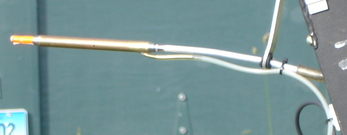

When I made a new pitot tube for my UltraStar, I made a concentric pitot/static tube. The inner tube the original 1/4" aluminum tube that was on the plane when I bought it, but i added an outer tube of 3/8" diameter brass with four small holes in the middle, tapered bushings at each end of the outer tube, and a small brass tube soldered to attach the static line. It works much better than having the static air just venting inside the instrument pod as the previous owner had it (every time I moved my foot the reading would change!)
It's still not entirely accurate, and I don't know why. At 30-35 mph it seems correct, according to averaged GPS readings upwind and downwind... but at 45 mph indicated (level flight at 5800 cruise) the averaged GPS readings are more like 55 mph.
A picture is attached.
Pitot-Static tube

Hi Dana,
very neat job.
