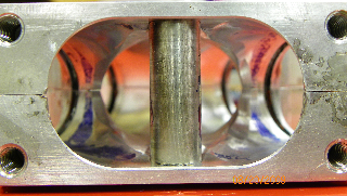

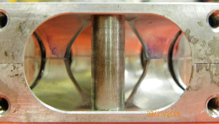

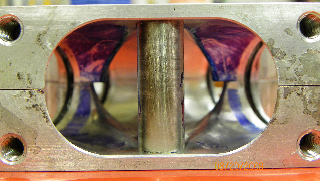

Right now I'm testing the benefits of having done some hogging out of
the inside of the intake manifold. I also made a nylon washer-like
device that filled the gap between the rubber coupling and the Jabiru
adapter snout (my terminology...they may have a better name for it)
that bolts to the intake manifold. This device also takes out the
"stepping" in diametrical differences between the TBI and the coupler
and the snout.
In looking through the intake manifold, I could see that the front
cylinders appeared to be starving for air flow, so I did a little
"porting" to allow them to breathe better. Initial flights show that
I didn't hurt performance any, but some more flying will tell if I
did any good. I can say that initially, at least, the cylinders all
seem to peak at the same time...same fuel flow (3.1 gph).....although
still not at the same EGT. And I understand that getting the same EGT
is not critical between cylinders. I need to run the GAMI Lean Test
again to be sure, but initially I think I've got the EGT's peaking
Here are some pictures I took during the hogging out operation. The
first shows the view through the stock intake manifold, rear to
front. The second shows that the lower half of the manifold has been
cut, taking out some of the web that I felt was interfering with the
air flow to cyls. number 1&2...the front ones. The last picture shows
the almost finished job. You can see that there is more of the front
openings (where the intake tubes are inserted) visible, and that the
air should flow around the splitter/divider better. The factory had
apparently done some tests with shaping the splitter, and found that
its shape was the best they could do. I was even thinking of making
the splitter sort of hour-glass shaped, but decided to leave well
enough alone for the present time. Gotta save some fun for another
day. : )
Lynn Matteson
Jabiru 2200, #2062, 744.1 hrs
Sensenich 62"x46" Wood prop
Rotec TBI-40 injection
Status: flying
and the snout.
day. : )
