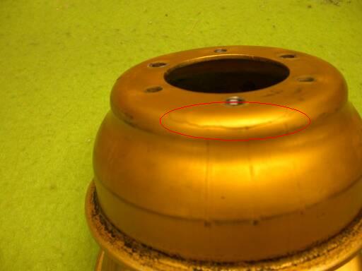

While we are rehashing old warnings, I'll throw out another that I
mentioned around 2005. MATCO 6" aluminum rims that were optional
upgrades on many Kolbs over the years. If memory serves they were MATCO
model number MH6B and were usually anodized gold. They were a spun rim
and had some problems with the web of the rim cracking out where it bent
around and formed the flange. These were later changed ...the
replacements I got were both thicker material and a different profile
shape as well. I know of 2 that let go in use 1 during an otherwise
nice landing that then caused a pretty spectacular sudden stop...I took
the hint and pulled mine off and broke them down to inspect...lo and
behold one of mine had already cracked about 45 degrees of the web to
flange bend. So I can personally attest to 3 failures or imminent
failures of this part. While you are pulling maintenance , checking
those cable tangs why not pull the rims (if you have that style) and
give them a once over?
I am attaching a picture of my cracked rim to show you where to look...I
drew an ellipse around the crack...
Fly safe,
Jeremy Casey

Thom Riddle
Posts: 1597
PostPosted: Wed Sep 02, 2009 3:14 am    Post subject: Re: always do your preflight! Reply with quote
Jeremy,
Thanks for the Matco wheel information. The Slingshot I bought a month ago has 6" Matco wheels, gold in color but not sure of the model number. The airplane was built in 1999. I'll be checking mine soon. Appreciate the heads up and the photo.
