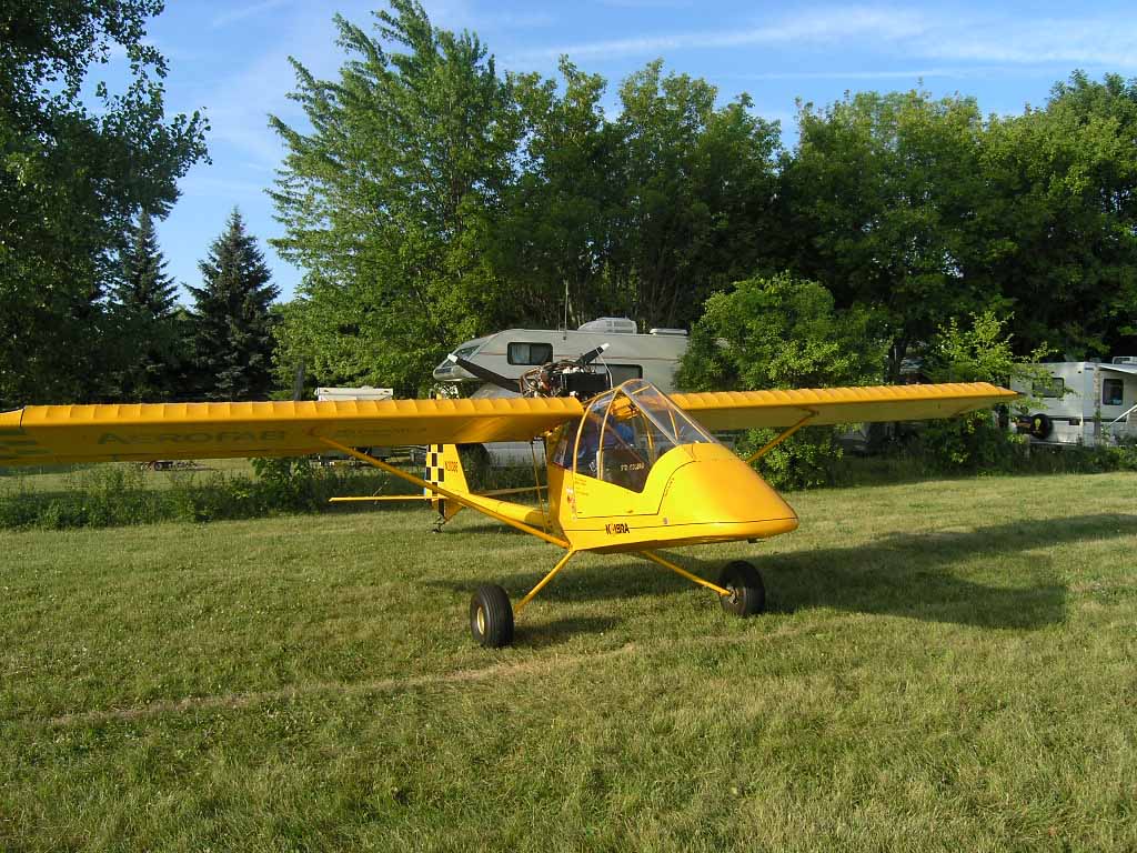

Chris, I'll be there weather permitting. I am there from Saturday to Wednesday morning. I usually park the Kolbra on the west side of the ultralight runway and camp on the other side of the fence in the picture. The EAA wants me to park on the east side of the runway, but I like to camp with access to showers, toilet, and car so we can drive into town for dinner and stay out of traffic. We can see the afternoon airshow and sip on our drinks from that campground.
Ralph
Ralph:
That's a good looking bird.
I know exactly where you are parked.
Reminds me of the many years spent in the UL Camp with friends.
Are many people camping with their airplanes on the east side of the
airstrip since they started allowing that?
Big problem camping where spectators can see your airplane is pushing it to
your tie down spot. UL and Lt Planes aren't authorized to taxi like the
rest of the Oshkosh fleet of visiting aircraft. EAA still treats us like
bastard children way down on the south end.

John Hauck:
Ralph:
Big problem camping where spectators can see your airplane is pushing it to your tie down spot. UL and Lt Planes aren't authorized to taxi like the
John and others,
Camping on the east side means pushing the plane and it's harder going to the strip because it's uphill slightly. One advantage of parking there is your plane gets more attention and you could get in an EAA video. Only a few of us park on the west side now, but I do it for convenience. Maybe this year the EAA will not allow me to park there.
Ralph
