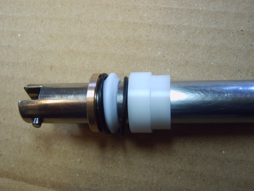

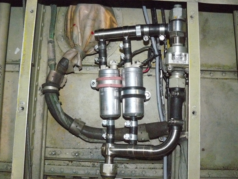

we mounted two Pierburg fuel pumps under the passenger floor in our 18 T after experiencing severe loss of fuel pressure in warm weather during the take-off run. And you just don“t want to deal with that once again. I have to add that we run the Yak on leadfree auto fuel from the beginning for 5 years now - as most of you would do facing the price of avgas in Europe. With these pumps plus a one-way valve feeding into the standard fuel line pressure stays above 0.5 bar in all conditions and this is only used for pressurizing the carb before engine start and for take-off. I can“t see how to manage an electric primer pump replacement with good control so we keep the manual pump for our starting technique. No big deal to keep that sealed as the critical parts can be accessed from within the cockpit. It is true that the action of the plunger is not really smooth with an o-ring acting on the steel plunger in non lubricating gasoline. So we made up a set of seals from teflon and nylon/polyamide plus o-rings as elastics - no more problems.
I can think of a setup feeding fuel into the primer line going into the induction chamber in case of a carburettor failure. All you“d need is a T fitting and an electric/mechanic valve and some flow-limiting valve which you set up on the ground for about half power to get you to an airfield in emergency.
I remember a story when the seal between the oil pump and the fuel pump failed . The consequence was that the oil pump fed oil through the fuel pump to the carb at 2-3 bar and the pilot was lucky to make it to the airfield - just - with minimal power - and oil - left.
Cheers
Vic
