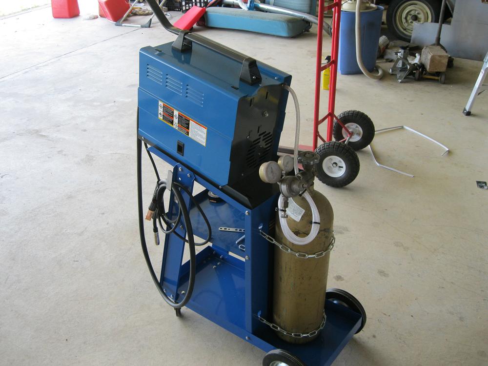

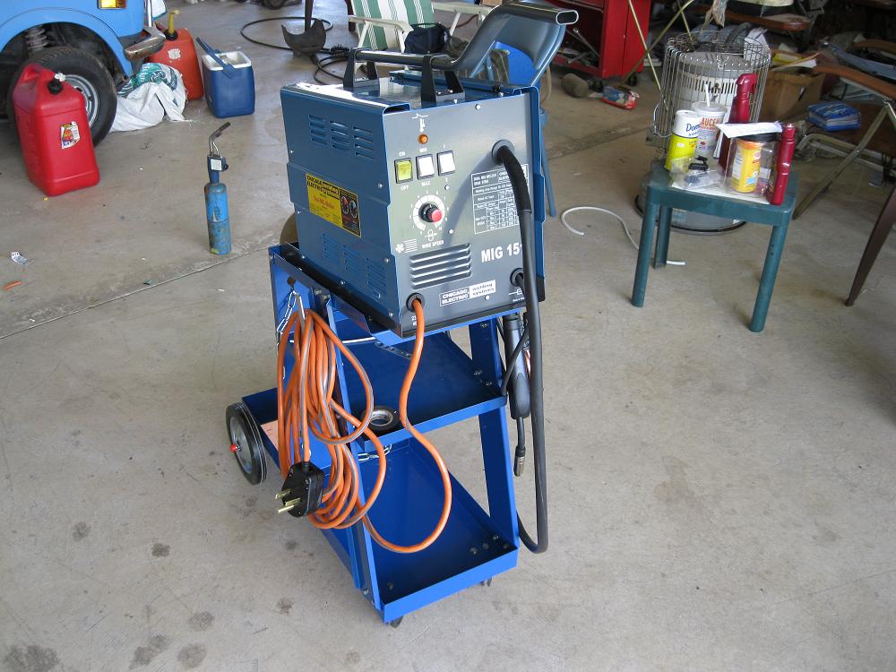

I bought this mig welder from Harbor Freight this summer on sale for $179.00....the stand was $49.00 ...This welder welds beautiful ! You won't find anything this nice for this kind of money...tank and gages are extra...
Welds with gas or with the flux core wire....just change wire and power leads....I did add a 25' cord too....
just something to consider....

Chris- Nice knowing that brand does work. A couple of friends- years ago- bought the cheap Chinese angle grinders. They got 10 minutes out of them, never to run again.  I have the Harbor Freight electronic helmet. Utterly reliable, and $39 on sale. The electronic helmet is great for MIG work. With the Chinese stuff, I guess you have to spec it out exactly for them to make it. otherwise, it will just look like the tool and not work like it.
