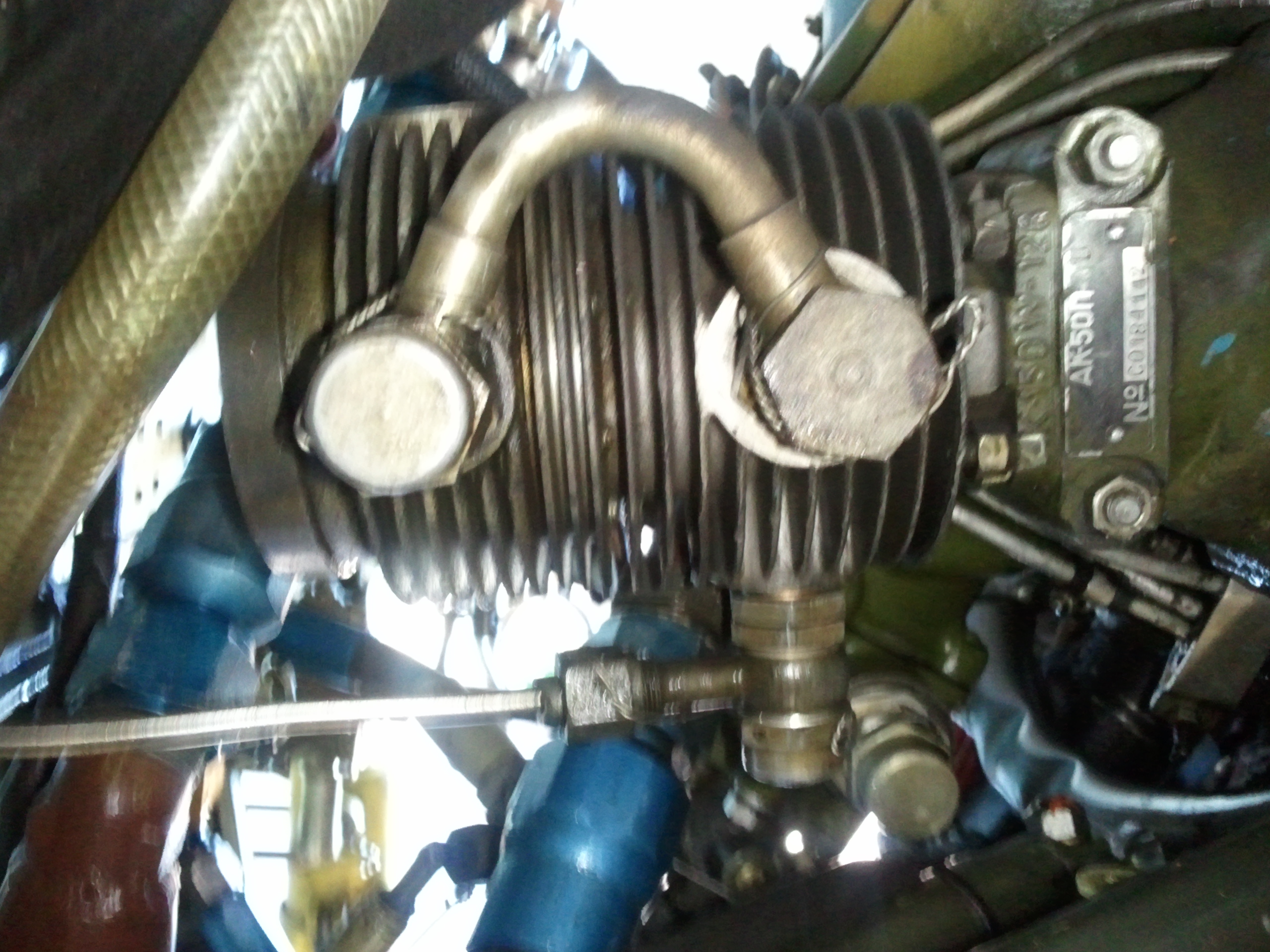

PostPosted: Fri May 11, 2012 7:18 am    Post subject: compressor issues Reply with quote
Attached is a picture of the compressor I have. It has an extra compression stage than the normal M14P compressor. Like I said, mine is orientated differently because of my hose routing. I did incorporate an unload feature. This feature works well but you must remember to close it before landing. I forgot once and it lead to hours of confusion as to why I wasn't making air. Other than that, I have seen no adverse affects.

A few facts to consider:
AN-2: 4700 pound aircraft with a 1000 horsepower engine. Pneumatic brake system and compressor designed to bring it to a stop.
Take air compressor off 1000 HP engine and put it on 360 (or less) horsepower engine.
It fits.
Pumps up tank faster. You betcha. Which means it also places a much heavier load on the engine drive system that powers it while doing so.
The result of doing that long term?   I have no idea. Maybe someone else does. I have no doubt that it works well short term. It may turn out to be a really good mod, but make no mistake that it will rob more power from the engine when it is under load. Not saying the sky is falling. Just saying that it is wise to consider such a change carefully.

PostPosted: Fri May 11, 2012 8:12 am    Post subject: compressor issues Reply with quote
On Fri, May 11, 2012 at 8:16 AM, Larry Pine <threein60(at)yahoo.com (threein60(at)yahoo.com)> wrote:
... I did incorporate an unload feature.  This feature works well but you must remember to close it before landing.  I forgot once and it lead to hours of confusion as to why I wasn't making air.
Ah, the law of unintended consequences. In the end, "improvements" rarely offer as much advantage as initially believed.
Nice compressor tho'. Where'd you get it?

It was originally installed when I bough the engine from someone in a create from Russia.

How do you unload it? Pix?
Bill
On May 11, 2012, at 9:16 AM, Larry Pine <threein60(at)yahoo.com (threein60(at)yahoo.com)> wrote:
[quote]Attached is a picture of the compressor I have. It has an extra compression stage than the normal M14P compressor. Like I said, mine is orientated differently because of my hose routing. I did incorporate an unload feature. This feature works well but you must remember to close it before landing. I forgot once and it lead to hours of confusion as to why I wasn't making air. Other than that, I have seen no adverse affects.
