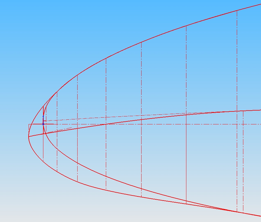

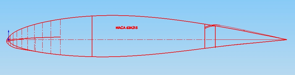

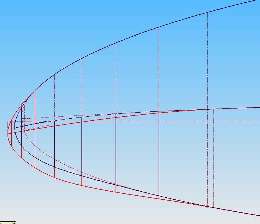

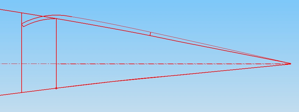

I got the late Harry Riblett GA AIRFOILS Book the other day.
He has some really good information and fixes in his book, and the story about how he comes
to develop his own airfoils the GA- series.
In the book is a “quick fix” for the NACA 64-212 with a cuff going 10% of the chord on
bottom surface.
Instead of the super elevation LE of the NACA, he draws in a 12 degree initial camber angle
and a new mean line that create the cuff. The good with this mod is that it maintain the
laminar flow. Not so with VG’s
This cuff on the KIS-1 will be about 8 mm forward and little more thickness under the nose, a
little to much for a “micro” job, but hot-wire foam inlay and glass, or pre- molded will work.
He also show that the flap top should have a raised and curved surface, this is not really new it
have been used on many plane since before the WW2, but by making the control surface
thicker then the true airfoil, it re-energize the air, so it follow better and also have less drag,
almost as there was no gap from beginning.
This will work on the elevator as well, but then at the bottom.

PostPosted: Thu Jan 24, 2013 5:27 am    Post subject: KIS TR-1 Airfoil Reply with quote
Not being an aeronautical engineer, could you draw me a picture of what this looks like? I'm very interested to know more.

PostPosted: Thu Jan 24, 2013 6:06 pm    Post subject: KIS TR-1 Airfoil Reply with quote
Jan, Would this mod change the flight envelope, move it, widen it or what? Since it would increase lift, would it up the useful load?  Thanks for your reply.

PostPosted: Thu Jan 24, 2013 7:11 pm    Post subject: Re: KIS TR-1 Airfoil Reply with quote
I will test it in virtual wind tunnel, and we see if it as good as Mr. Riblett say, what we can see is that the nose is corrected and this lead to increased camber, as seen the original nose is above the chord line, meaning it have less camber and initial mean line slope then the original mean line it self, due to the way Naca place the original uncambered airfoil 63A015 along the mean camber line.
more camber give more lift and higher max CL, but due to the change in camber is at the first 10% the negative moment in unchanged.
the dropped nose will increase the stall angle.
It is late here, but I will pick the coordinates out tomorrow, and see what the DesignFoil program say. but as with all computer program they are poor at detached flow.
Jan

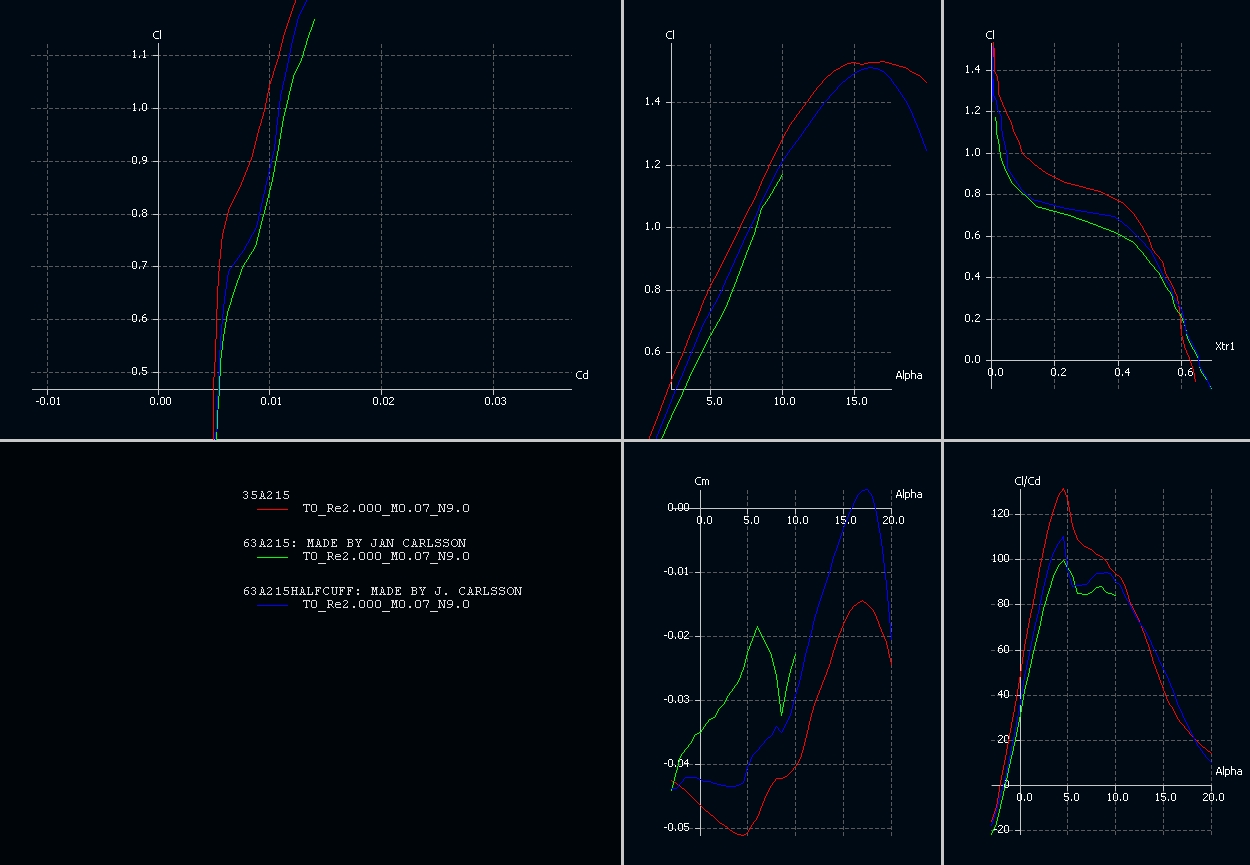

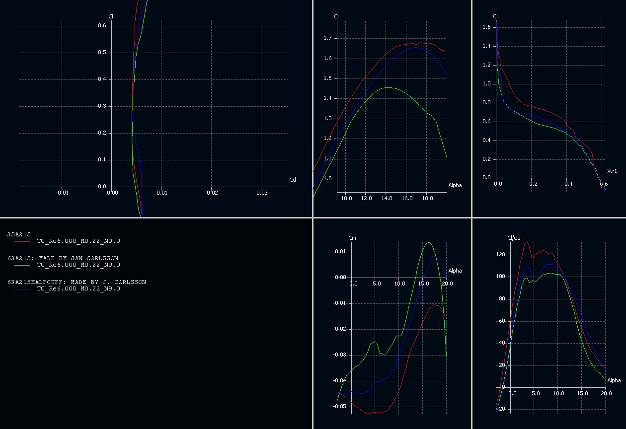

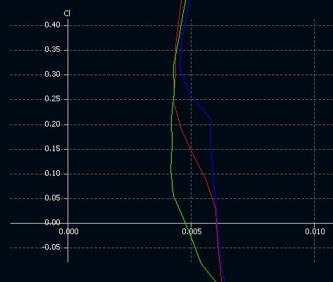

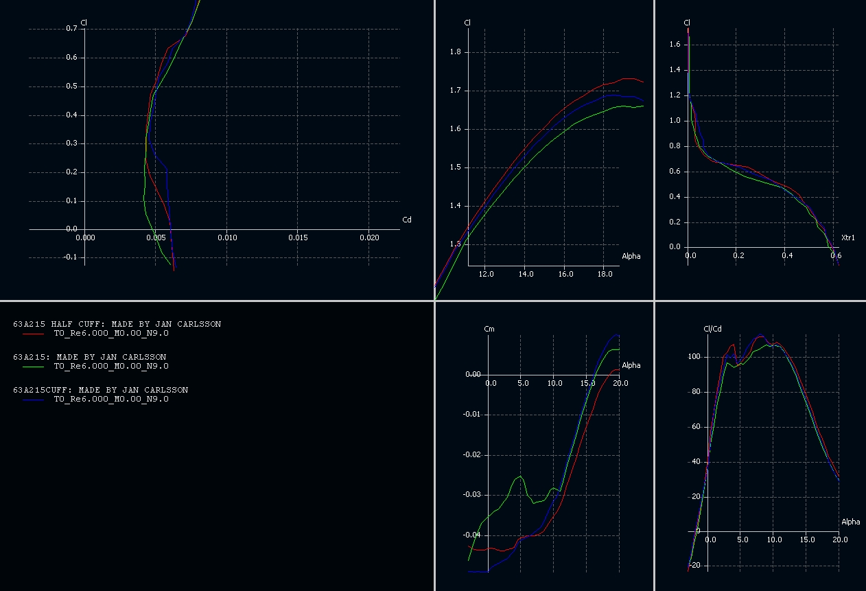

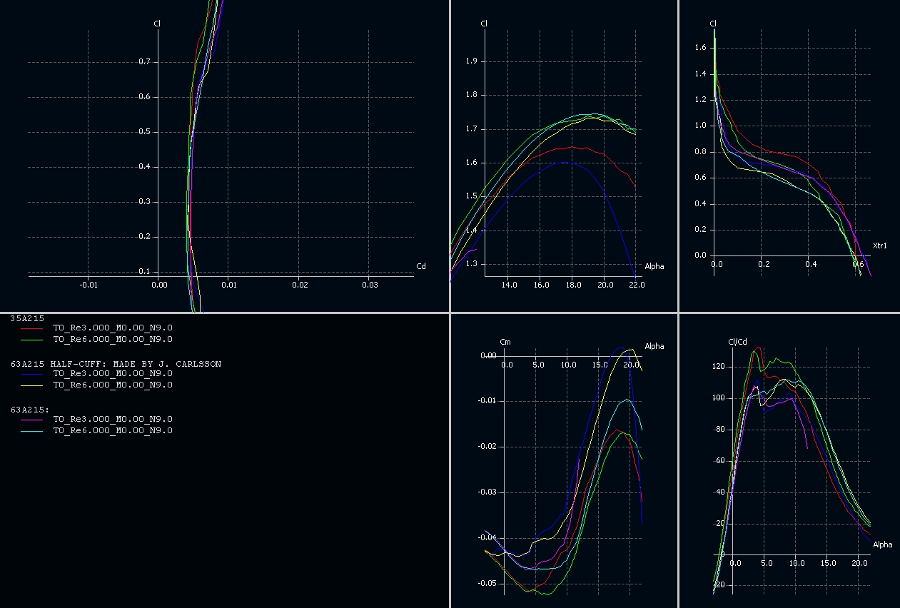

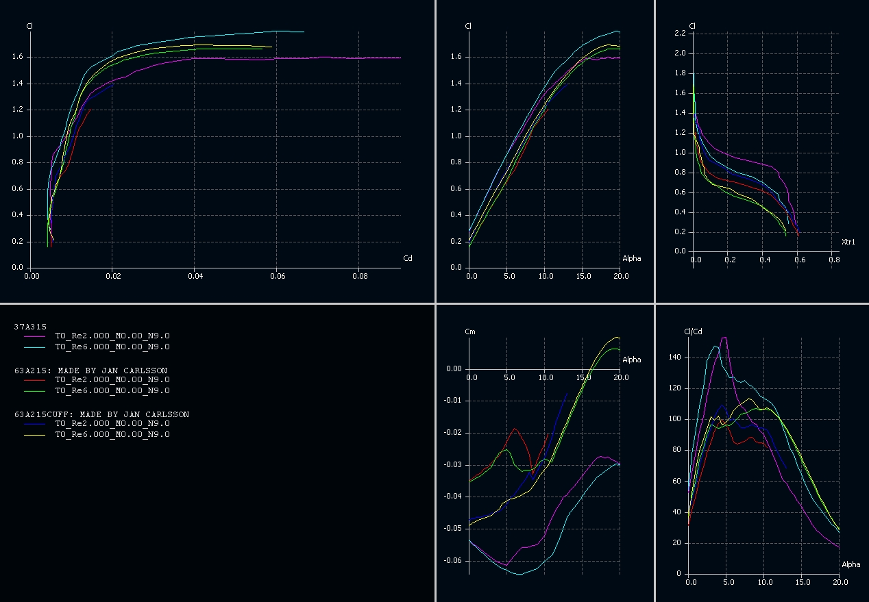

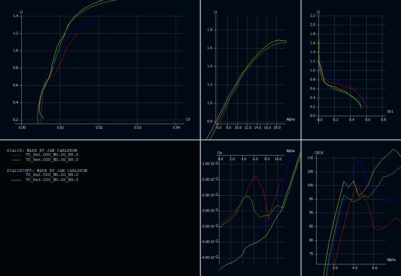

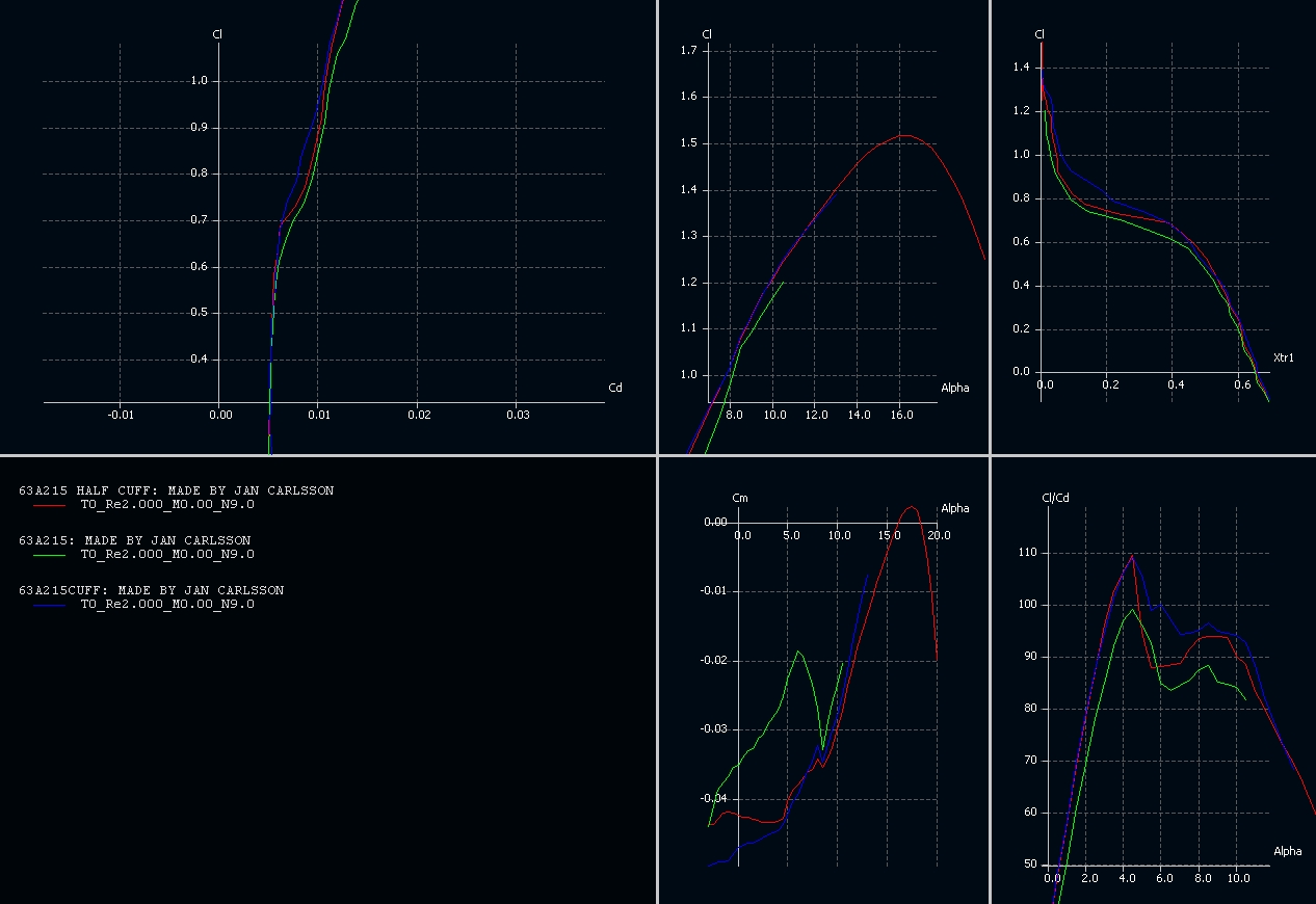

PostPosted: Fri Jan 25, 2013 9:40 am    Post subject: Re: KIS TR-1 Airfoil Reply with quote
Hi Al'
this is analyze of the KIS-1 airfoil, not the 4-Cruiser that have a different
airfoil the N-65-415
I tested the Naca 63A215-Coff'd airfoil in 3 airfoil program, DesignFoil,
JavaFoil and X-foil.
in all 3 I got lower drag with the coff's airfoil.
In DesignFoil the max lift was lower with coff, sounds strange.
the other show higher CLmax with the coff as expected.
I have not used X-foil before so downloaded it and made some test runs, still more to learn there. but nice thing when can run 2 or more airfoils at the same time, and see the difference. Absolute numbers should we take with a grain of salt, but side by side runs, show the difference.
at the end I run it with GA 37315 that really outperform 63- series with and without cuff.
the pure 63A215 seems to have a peculiar behavior at 5-6 degree of angle, where the -moment all of a sudden increase with increased angle, will lead to a nose down force. this is gone with the cuff.
in all, the cuffed airfoil will have less drag, except at lower CL then 0,3 where it start to get more drag when bottom is going from laminar to turbulent flow, if we/you don't "cruise" WOT at or below Sea level all the time, it have little practical importance, at 75% or less, and higher alt the cuff'd airfoil will win.
the computer programs and theory say that, it will have higher CLmax, lower drag, better climb. And looks like it will have a gentler stall, and probably work better with flaps.
Any takers on real "wind tunnel" flying testing?
If it can carry more weight? I say that is a question of wing strength. and power. See attached pictures, there is 2 Re. numbers for each airfoil, 2 and 6 mil. (stall and cruise) one pic with 63A plane and with cuffs, and one pic with the GA 37A315.
Jan
Ps. any comments welcome. Smile

mantafs(at)earthlink.net
PostPosted: Fri Jan 25, 2013 5:44 pm    Post subject: KIS TR-1 Airfoil Reply with quote
Hello Jan,
Thanks for doing the KIS TR-1 airfoil analysis. I think this is really helpful and useful.
But maybe I am reading the graphs incorrectly. To me it looks like the original airfoil is the best given the cruise speed, weight and wing plan of the TR-1. For example a fairly clean TR-1 with a 160 hp Lyc should be able to cruise at about 170 knots TAS at 8.5kmsl and 75%. This gives a CL of about 0.21 at 1450 gross. My O-235 powered TR-1 will cruise at about 155 knots TAS at 8.5kmsl and 75%. This gives a CL at gross of 0.26. Scott's IO-360 powered TR-1 will cruise at better (much better?) than 190 knots TAS. This gives a CL of under 0.17. At all of these CLs it looks like the stock wing has the best CL/CD. If you are below max gross the CL's are even lower and the stock wing is even better.
I also know that many do not cruise at 75%. But many also do not fly at gross. Much of the time I have flown was with 1 person and half fuel. With my O-235 powered TR-1 the CL would be under 0.2 at similar cruise solo. Even with just 65% power the cruise is about 145 knots TAS with a CL of about 0.23. The stock airfoil still looks like it has the least drag.
I know drag at cruise is not the whole story but you do spend most of the time in cruise. The climb and stall speed could be slightly better with the other airfoils.
I am not at all saying that the 63A215 airfoil is the best. Nor that with a smaller wing the other airfoils could work better. But it looks to me that you will reduce cruise speed with the cuff or the other airfoil is you keep the same wing and same gross.
Mark
Jan

Yes it give more drag with the cuff at speeds higher then the CL 0,3 as I wrote in previous post. and I realize it is not for Scott's light and fast plane.
To the "pure" CL given from weight, speed and density alt, we have to ad 0,02- 0,03 due to tail down force. (about 10%)
There is 2 NACA 63-215 airfoils, the one with a A is the one used on the KIS-1 this is the one without cusp, straight or almost straight upper and lower rear surface. said to have 0,0002 Cd more then the cusp'd airfoil, (like a mosquito shit on the LE) but simpler, more structure and more effective ailerons with the A model. this is the basic airfoil I used in this example.
The related Riblett airfoil would be GA 35A215, it is using Ribletts mean line and NACA 63A015 thickness distubution.
I am curious how much drag the modified wing with cuff will make, say at WOT 8000´I0-240, 1450 lb, My Propeller software say 179 mph 155kts TAS, thats what you guys say too, CL 0,25+0,02 = 0,27
The total drag will be 80 kg/ 176 lb.
the delta drag coefficient from the cuff is at CL. 0,27 = 0,000857 if the X-foil program is correct.
with the exposed wing area this give a Fo of 0,00594 m2 (sorry for using metric system) the q is 314,3 kg/m2 and then delta drag is 1,86 kg
at 175 mph q is 300,4 = drag is 1,78 kg
so new speed will be 174-175mph/151-152 kts
BUT at that speed CL is 0,27 + 0,02 = 0,29 where the drag penalty is less then half of what it is at CL 0,27, so real slow down 1,5-2 kts.
At faster speeds the drag penalty will be higher!
The goal with the cuff isn't to reduce drag but enhance handling, slower stall speed, better climb, less erratic moment coefficient,
It is a quick fix for a faulty airfoil. if it paying off?
Flying slower than 150 mph IAS it will, maybe a cuff with half the LE drop will be better? I just used the example in the book. realising the concave spot under the nose where the cuff fair into the original airfoil would create drag at small alpha. and sure it did.
This have to be seen in relationship to the drag with VG's on the wing, any one with real numbers?
Jan

Okay, always goes faster second time.
Riblett talks about his mean line have 0,3% nose drop on the CL 0,2 mean line, so I used that, and it is half of the first one.
Very interesting result.
I used single Re Nr. 2 and 6 million. 47,5 & 143 kts SL to make the graph clear, and zoomed in the interesting parts at the speeds
at 2 mill the original and the full cuff airfoils polar curve just stop at CL 1,2 and 1,4 but not the half cuff, why i don't know. maybe the half cuff is good?
at Re 6 mill the half cuff have half the drag penalty of the full cuff at CL 0,15 and brake even at 0,25 with original airfoil.
And hardly any measurable penalty at CL .2 (,17+,03)
at CL 0,6 the half cuff is better.
Higher CLmax at higher alpha, and Cm curve more even.
Okay good exercise.
Jan

I made a "final" test with original NACA 63A215, Half-Cuff on the same airfoil and the Riblett GA 35A215, all these have the same basic symmetric airfoil, except the Half-Cuff that is modified under the LE, The NACA and the Half-Cuff have the same mean line, except at the nose of the Half-Cuff, the GA have the Riblett GA-2 mean line.
It is seen that the Riblett will have a "softer" stall, seen on the more rounded polar curve at stall, meaning the stall will be more like a mush then a sharp stall.
The Half-Cuff will have almost as low stall speed as the Riblett, but little sharper stall, but what happens to the N-63 at low speed? laminar bubble that burst?
The Half-Cuff will be like a in-plant for the KIS, and VG's will be more like a band-aid.
Nothing wrong with the KIS-TR1 that can't be fixed.

After I got the GA-35 and 37 A215 typed in and checked in 3 airfoil program, I got to this conclusion:
Can not trust any program to 100 %, we can see differences though, and they are all the same in the different programs, Xfoil seems to be more sensitive for un-even coordinates, but good thing is the polars can be zoomed in and out.
I found the erratic in Cm on the N-63A215 airfoil in Xfoil to be due to the last half% of the chords coordinates was making a cone to almost zero thickness, when corrected to have some thickness as the other airfoils that erratic Cm curve (moment) was almost gone, the other programs like DesignFoil and JavaFoil don't seem to be so sensitive.
What I can see is that the GA35A215 will have the lowest drag, specially at climb, the GA-37A215 will have little higher max CL.
The GA- airfoils have a little rounder/softer stall.
The Half-Cuff will help on the N-63A215 as it seems, but have to be tested in real world.
Jan Carlsson
