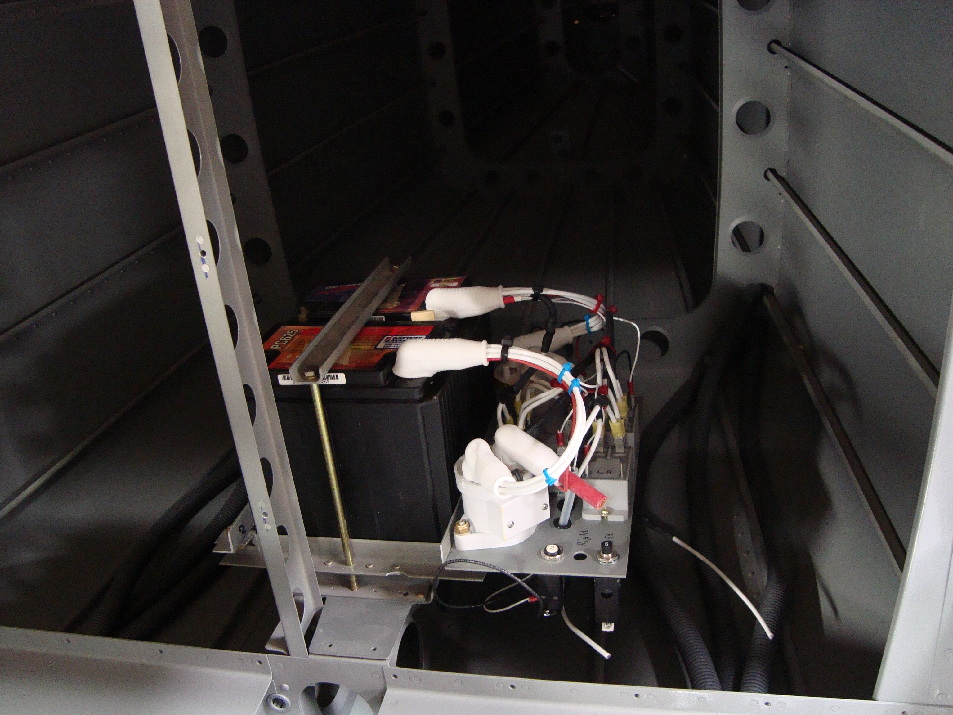

PostPosted: Wed Nov 20, 2013 4:10 pm    Post subject: life of the Odyssey Reply with quote
Here is how I did mine:
http://s403.photobucket.com/user/dclifford01/media/RV10/IMG_0006.jpg.html

carl.froehlich(at)verizon
PostPosted: Wed Nov 20, 2013 4:42 pm    Post subject: life of the Odyssey Reply with quote
I used two PC-625s and modified the mount. The hold down bolts remain in
the same place. I find the 625s (17ah, 200CCA and 15 lb) a better form
factor to work with than the PC-680s (16ah, 170CCA and 16lbs).
Carl
