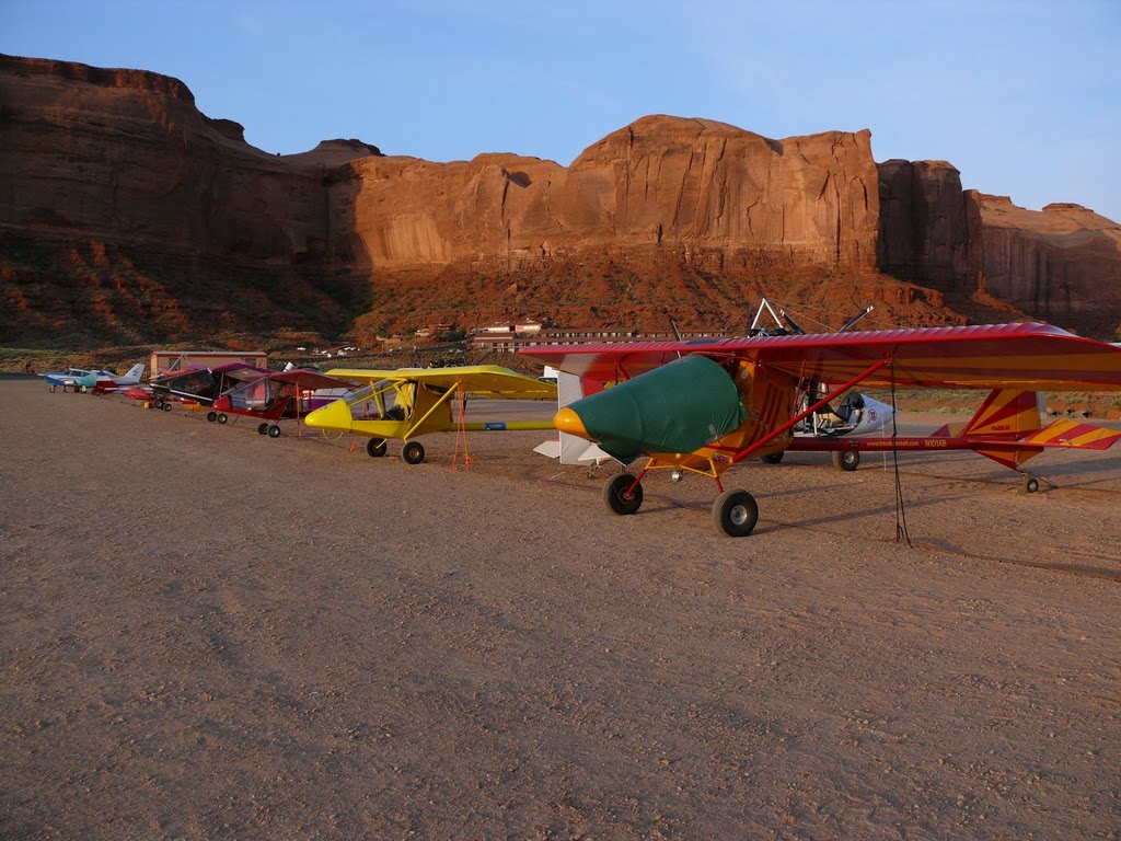

Attached is a photo from one of our Monument Valley Flyins. Glad we had the
opportunity to do those.

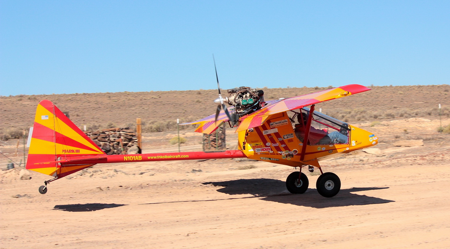

I included another photo from my flight to the Rock House near Burns Junction, OR, September 2014. I had just completed this 24.0 flight to celebrate my 75th year, and to enjoy the company of my Kolb friends that annually gather there. What a crew!
