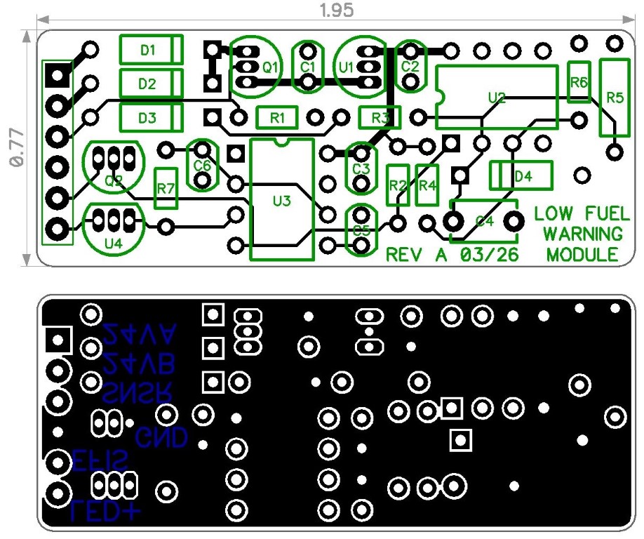

911pete wrote:
I’m using the Garmin G3X with a GAD27. [ . . . ] Either of these units can be configured for the warning to be active high or low.
OK, I've made it active low. If you change your mind about avionics it will be compatible with anything on the market.
The schematic, wiring diagram and functional description are attached to this post. All parts are through-hole, so assembly will be easy. The bill of materials is here:
https://www.digikey.com/en/mylists/list/CFEKJK5A1K
For anyone else who's following this thread: please critique my schematic. The more eyes on it the better; let's find my mistakes at zero altitude and zero airspeed.
NOTE: I assumed that the fluid detection sensors have open contacts in the absence of fluid and closed contacts in the presence of fluid, that the "C" (common, white) wire of the sensors will be connected to 24V and the "NO" (normally open, brown) wire will be used to signal downstream circuits. So, if fuel is detected then 24V will be present on the brown wire, and if fuel is not detected then the brown wire will be open circuit.
When everyone's happy, I'll turn this into a circuit board layout.

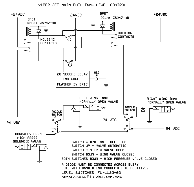

PostPosted: Mon Mar 02, 2026 11:34 am    Post subject: Re: Fuel System Manager Reply with quote
I am not necessarily recommending dual relay control of wing tank valves.
But I have attached a dual relay option.
If automatic pumping from one tank is lost due to relay failure, then automatic
pumping can continue from the other tank. But relays rarely fail.
A disadvantage of two relays is more complexity.
Kudos to Eric for designing a low fuel flashing warning light.
 Filesize:  11.5 KB
 Viewed:  4677957 Time(s)

user9253
Joined: 28 Mar 2008
Posts: 1975
Location: Riley TWP Michigan
PostPosted: Mon Mar 02, 2026 3:12 pm    Post subject: Re: Fuel System Manager Reply with quote
Pete,
It seems that you want do away with the manual mode and make the center
switch position automatic just like the top position.
Why not just use a 2 position switch, OFF and AUTOMATIC?
Another option is to install a third level switch. Put it into the main tank vent.
If fuel ever gets that high, either from operator error or from equipment
malfunction, then it would turn on the red flashing alarm light.
It would be easy to add that feature to Eric's circuit board.
Joe Gores

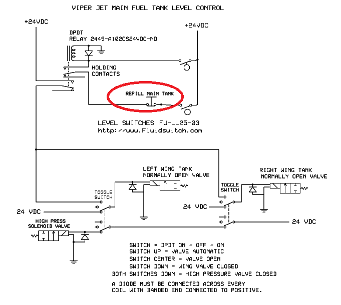

PostPosted: Tue Mar 03, 2026 10:43 am    Post subject: Re: Fuel System Manager Reply with quote
I added a momentary push button switch to the circuit (circled in red).
You will have to decide if this added feature is worth the risk of the switch
failing and causing the valves to short cycle on and off.
During descent to landing, the wing tank valves will open and close every 10
minutes to keep the main tank full. It is my understanding that you want the
main tank to be near full at end of flight so that it is ready for the next takeoff.
Pressing the momentary switch will interrupt the automatic cycling and cause
the main tank to start refilling immediately. If timed correctly,
the main fuel tank will be near full and ready for the next takeoff.

PostPosted: Tue Mar 03, 2026 11:47 am    Post subject: Re: Fuel System Manager Reply with quote
That’s a nice elegant solution.

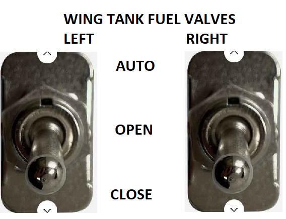

PostPosted: Fri Mar 06, 2026 11:13 am    Post subject: Re: Fuel System Manager Reply with quote
How will the switches be labeled for the wing tank solenoid valves?
Attached is one possibility.
 Filesize:  100.33 KB
 Viewed:  4677671 Time(s)
Joe Gores

PostPosted: Fri Mar 06, 2026 12:30 pm    Post subject: Re: Fuel System Manager Reply with quote
On another Viperjet they are labeled OFF/MAN/AUTO
user9253
Joined: 28 Mar 2008
Posts: 1975
PostPosted: Sat Mar 07, 2026 6:38 am    Post subject: Re: Fuel System Manager Reply with quote
The builder or experienced pilot will know how the switches work.
A new pilot might think,
"If the switch is off, then no electricity is going to the valve, so it must be open."
or
"OK, I put the switch in manual. Now how do I open and close the valve manually?
Joe Gores
911pete
Joined: 09 Aug 2018
Posts: 25
PostPosted: Sat Mar 07, 2026 6:48 am    Post subject: Re: Fuel System Manager Reply with quote
The “Heading” above the switches is “Fuel Transfer”, but I see your point

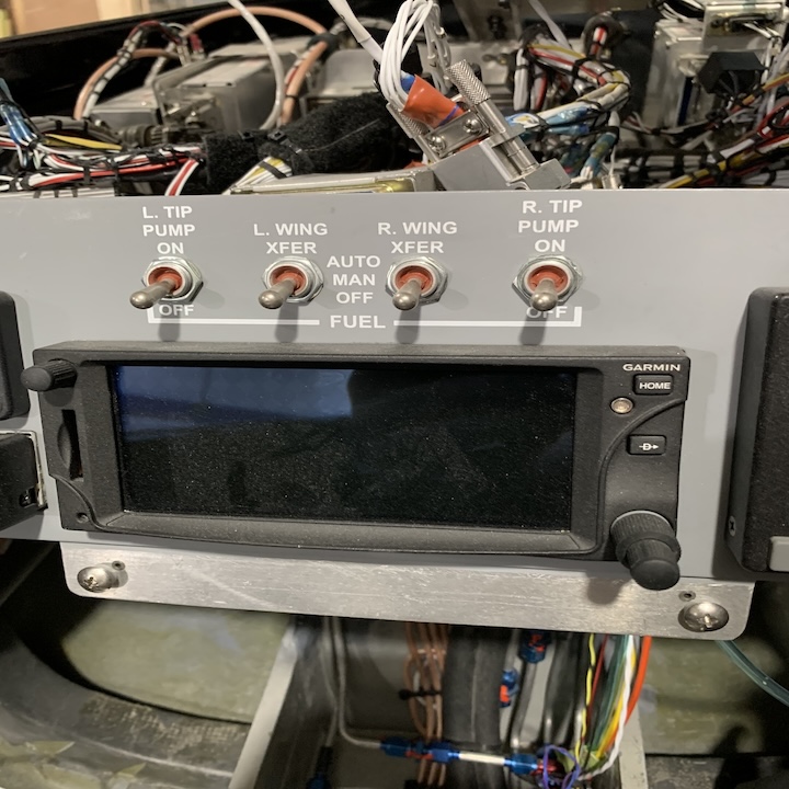

911pete
Joined: 09 Aug 2018
Posts: 25
PostPosted: Sun Mar 08, 2026 7:02 pm    Post subject: Re: Fuel System Manager Reply with quote
Here is picture of another Viperjet panel that shows what I posted earlier
I have flown many planes in the AF as well as the airlines. Warnings below a switch is something I don't think I've ever seen. This type of information is normally in the aircraft manual.
In previous posts I explained what happens in the event of loss of electrical power. There is no way for the fuel to overflow on the ramp if the engine is shutdown as the jet pump, the heart of the fuel transfer system, needs high pressure fuel from the running engine to move any fuel from the wings to the main tank.
Pete
