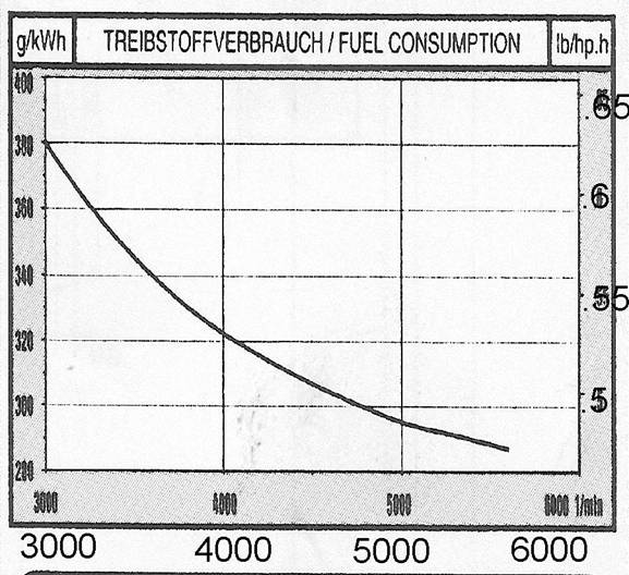

PostPosted: Tue Mar 02, 2010 7:49 am    Post subject: Fuel Reserve and UL's Reply with quote
lets face it...you are not going to get much more than 12 hp per gal per hour...
This is the fuel consumption chart for the 912 ul
Bottom scale is 3000, 4000, 5000, 6000
Right scale lb/hp.hr from bottom up is .5, .55, .6, .65
So do I interpret this to say the harder you push a 912 the less fuel it burns per HP per hour?
And if I interpolate correctly, is around 4.8 lb/hp.hour

Thom Riddle
Posts: 1597
PostPosted: Tue Mar 02, 2010 8:04 am    Post subject: Re: Fuel Reserve and UL's Reply with quote
Boyd,
The image is too small to see. If you have a larger version, please post it. I can't find a BSFC graph for the 912 engines in any recent manuals.

by0ung(at)brigham.net
PostPosted: Tue Mar 02, 2010 12:59 pm    Post subject: Fuel Reserve and UL's Reply with quote
Boyd,
Thom Riddle
This chart is a part of the pdf attachment. I added the numbers so they could be read easily.
Boyd
 Filesize:  59.86 KB
 Viewed:  11377 Time(s)
scan0001.pdf
Download
 Filename:  scan0001.pdf
 Filesize:  813.96 KB
 Downloaded:  1041 Time(s)
Thom Riddle
Posts: 1597
PostPosted: Tue Mar 02, 2010 1:05 pm    Post subject: Re: Fuel Reserve and UL's Reply with quote
Now I can read it.
All this says is that the efficiency peaks at about 5500 RPM, with approximately .45-.48 (eye-ball accuracy) lbs of fuel burned per hour per HP being produced. Since the curve goes up at lower speeds it will consume more fuel per HP produced at all slower speeds.
