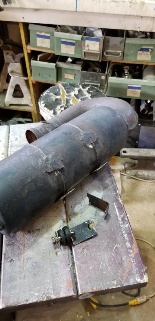

Interesting talk about muffler brackets. This is what happened to me yesterday on a short flight to Amery airport. I was already in my seat when the the guy I was chatting with asked what was wrong with my muffler. It was kind of angled a bit funny.He then helped me wire it together so it wouldn't fall off and scratch up my prop..

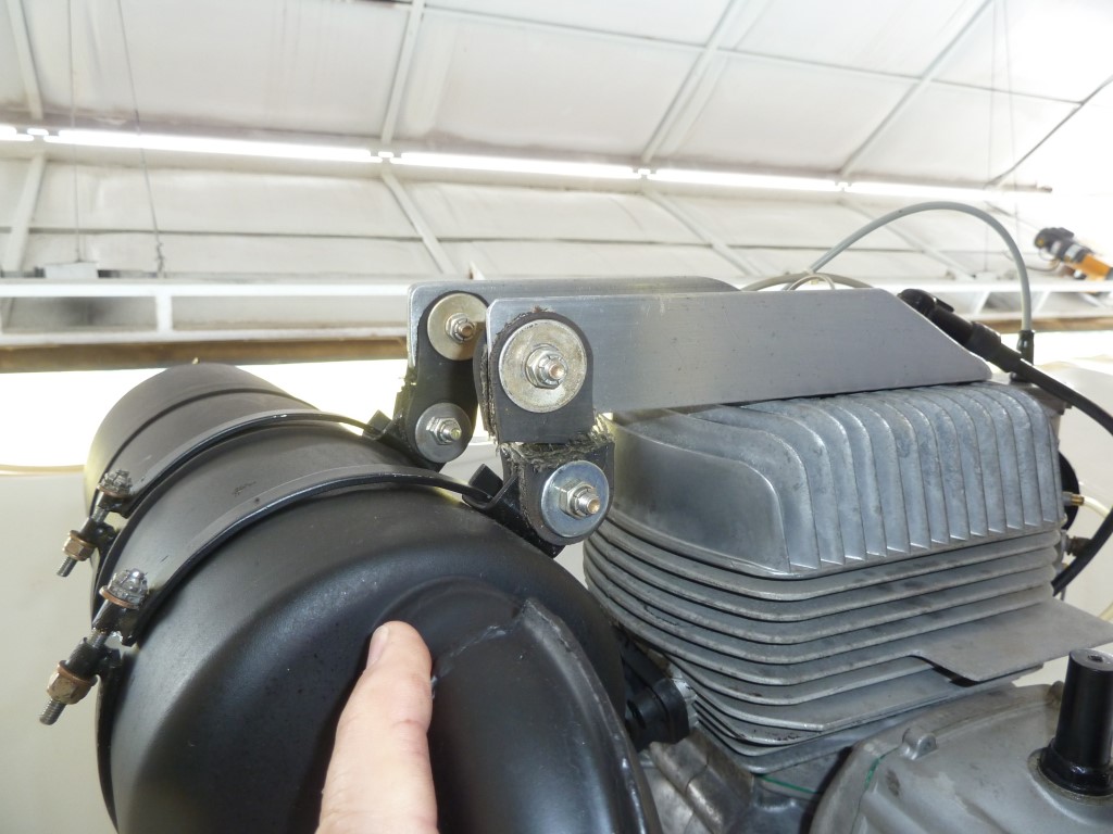

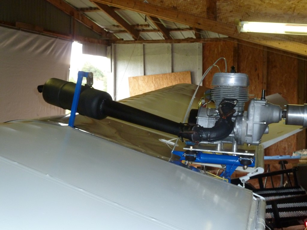

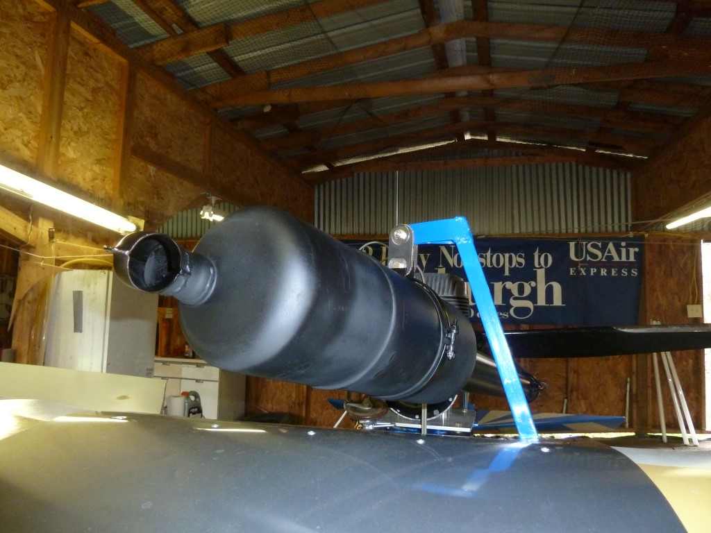

Unless your secondary goal is to get rid of vibration. Then you isolate it from the engine, keep it tight at the connections, and flexible at the mounts. Then (IMO) you have the best solution: reliability and less vibration.
The original muffler mounting on the 277 on the Firefly was set up to be tight, and it shook worse than you could imagine. We assumed it was because it was a single. Wrong. it was because the muffler was too tight.
A single cylinder engine waving that muffler back and forth 5,000 times a minute was a disaster waiting to happen. And it very nearly did: during the 45 minute ferry flight from the test field to David's hangar it broke 3 out of 4 new muffler hangars.
The first picture shows that setup with the original curlyque muffler.
The current setup is in the later pictures, there is no stress on the muffler hangars and vibration is about 90% less, and at 5500 rpm (the sweet spot for this engine) there is literally no vibration now.
The goal was to let the engine move without it also moving the muffler - or at least moving it as little as possible. So far it seems like a good plan.
