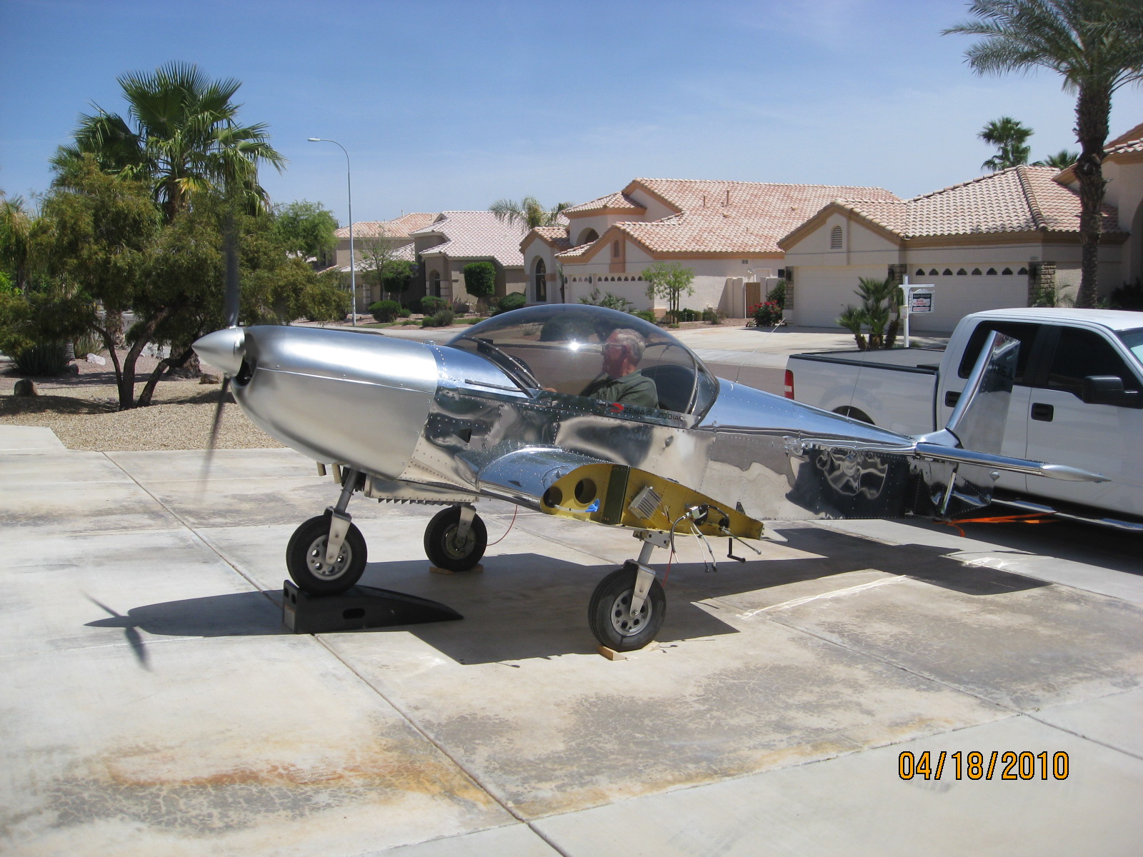

Steve,
I've attached a photo of how I performed this test. My drive way has a nice slope to it. I then ran the nose wheel up a ramp. This gave me a angle close to the stall angle or climb out angle. I then blocked the mains and tied the tail to my truck. The airplane was pointed away from my neighbor's houses. The header tank only had about 1/2 gallon of fuel, so the fuel pump was well above the fuel level. The test was run with only the motor's mechanical fuel pump.
