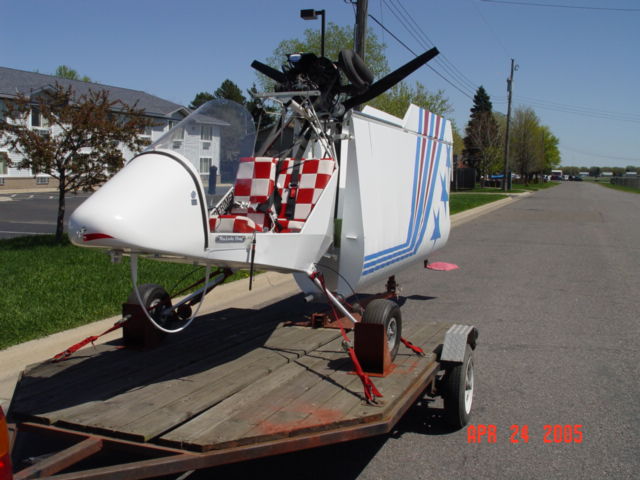

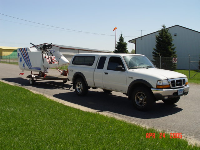

Firestar on Trailer... 22 ft plane on a 10 ft Trailer...
It pulls great, no problems....
Gotta Fly...
