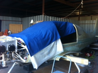

Well it seems I went from so hot that I needed to cool the epoxy to prevent premature setting up to temps too cool for good wet out and cure. Heat gun solves the wet out and nice warm electric blanket should give a good cure and windscreen is in place.
