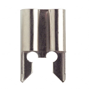

PostPosted: Tue Nov 05, 2013 8:53 pm    Post subject: Bussing W58 Series Breakers Reply with quote
At 06:53 PM 11/5/2013, you wrote:
Does anyone have a picture showing a row of W58 series (reset-only) circuit breakers w/ .250 quick connect terminals and how the feed side was bussed?
I can see using several quick connect terminals jumpered together but i'm curious about other more elegant solutions.
Keystone electronics makes a .250 wide
faston socket for use on etched circuit
boards. A bus-board could be fabricated
to accept a row of these clips spaced at
what ever matches your breaker layout.
[img]cid:7.1.0.9.0.20131105224658.01f16878(at)aeroelectric.com.0[/img]
This would make a very low parts count
bus-bar for fast-on tabbed breakers.
 Filesize:  27.83 KB
 Viewed:  15040 Time(s)
uuccio(at)gmail.com
PostPosted: Tue Nov 05, 2013 9:46 pm    Post subject: Bussing W58 Series Breakers Reply with quote
jluckey(at)pacbell.net
PostPosted: Wed Nov 06, 2013 11:50 am    Post subject: Bussing W58 Series Breakers Reply with quote
Now, why didn't I think of that???
I may have a few of those clips left over from a previous project. Don't even need a circuit board, I could simply solder them to a brass strip to form a buss.
Thx Bob,
-Jeff

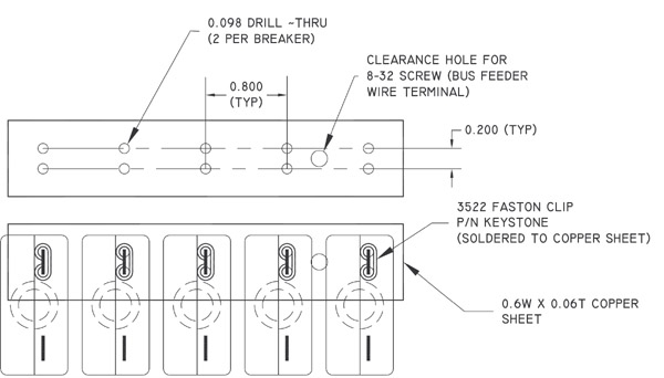

PostPosted: Wed Nov 06, 2013 3:58 pm    Post subject: Bussing W58 Series Breakers Reply with quote
FastOn socket for use on etched circuit
If you're really handy with sheet metal and
getting rows of holes accurately located, you
could fabricate from scratch . . .
[img]cid:.0[/img]
Suggest you not try to bus more than 5 breakers
at once. The finished bus-bar needs to press-on/
pry-off of n-terminals all at once. Unless
I could locate the holes on a digitally indicated
milling machine, I'd probably go the etched
circuit board route. $60 will get you 3 boards
5 breakers long that can be sheared into 3
bus bars each. Enough material with precisely
located holes to neatly tie 45 breakers together
in groups of up to 5.
Have you bought the breakers? They are available
in screw terminal versions . . .
 Filesize:  65.46 KB
 Viewed:  15030 Time(s)
PostPosted: Wed Nov 06, 2013 5:30 pm    Post subject: Bussing W58 Series Breakers Reply with quote
At 02:09 PM 11/6/2013, you wrote:
I think I’d like to give that a go too when I
upgrade my current wiring… Can a circuit board
carry enough current though? The copper layers
don’t look very thick. On the other hand, the
brass strips that are found in home electrical
stores seem a bit oversized to the task.
Yes, the number of breakers that can be fed
from one piece of double sided board won't
overheat it. You also connect the feeder
wire as close as practical to the center
so that copper clad is only 'feeding'
two breakers.
PostPosted: Wed Nov 06, 2013 5:32 pm    Post subject: Bussing W58 Series Breakers Reply with quote
yes. you need to fixture them to be
VERY well aligned before soldering.
Normal to the buss surface and no
twisting of the breaker terminal.
