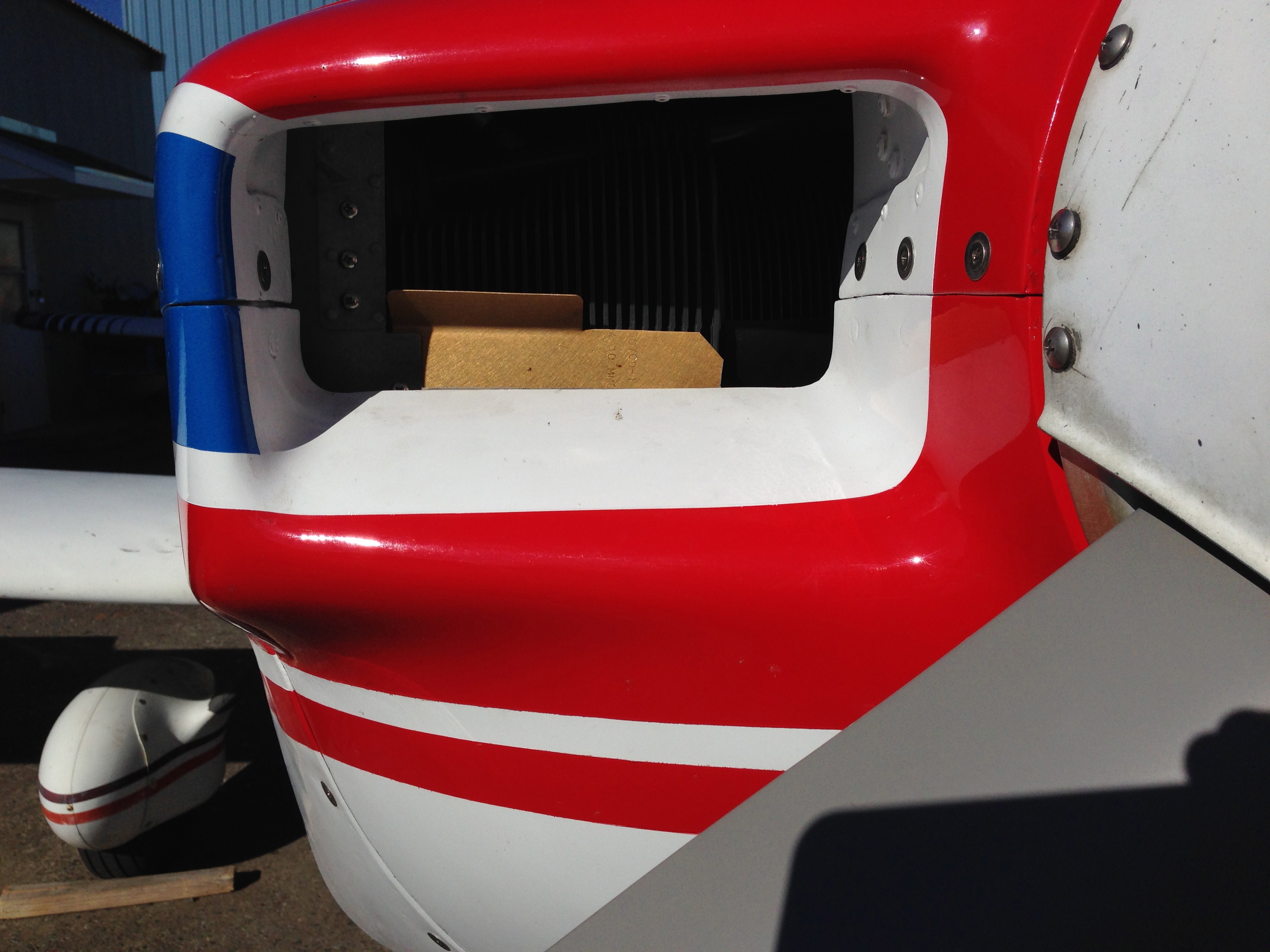

I tried this little baffle on #1. The result was that #1 now has a little higher temps and #3 has a lot lower temps.

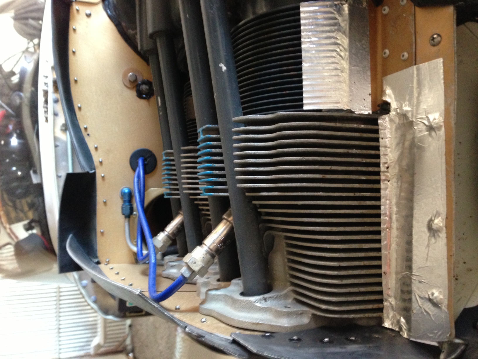

Looks a bit like my adjustable baffle (read temporary)
