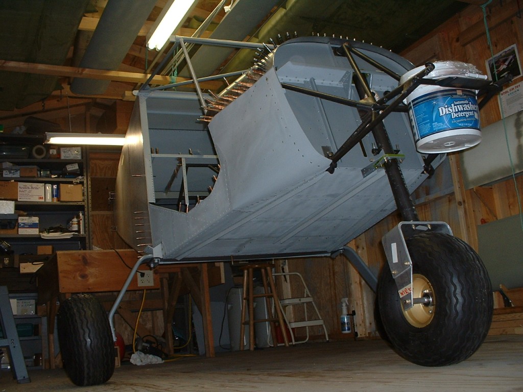

I used the Balloons too. They inflated at 3 psi. Didn't like the noises coming from my tank. I certainly would not use more than 3 psi. I guess I don't need to use any sealing compound in them.
Bye the way I'm on wheels now I started from plans in 1991 and never thought I'd see this day. ....Geoff
