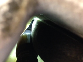

The spar is as thin as I could make it. Yesterday was the trial fit of the left wing. Nothing has changed except for the spar dimensions, so it should go right in. It does……..except for the last 1/8 inch. Frustrating.

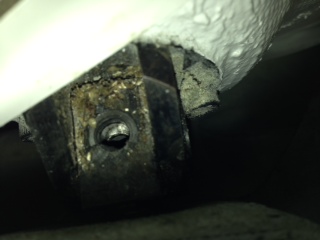

I've replaced the top air brake bracket screws with flush and it looks like the added BID that is in the upper corner of the tunnel has some high points that are contacting the spar and preventing the aft pin on the fuselage side from going all the way in, due to the spar not being quite all the way forward. I hope so, because I don't know what else it could be. The difficulty is that it is difficult to see what is going on in the tunnel and the wing root fairings prevent seeing what is going on with the sockets - especially the forward one. Not looking forward to reaching in there and sanding and sanding and sanding.
I'll attach pictures. Any words of wisdom would be greatly appreciated.

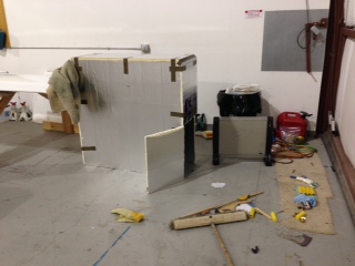

I do have an oven setup for post cure, however. Using foam panels and a thermostatically controlled heater, I am able to maintain a range of 120 to 125F. That is measured by a meat thermometer at spar level in the box. It can also ramp up the temperature like prescribed.
Post Cure Oven.
Pin not quite in - 1/8 to go. Close, but no cigar.

Possible interference. Hard to see in the picture, but I'll be using a remote camera today

Inserting a very small web cam located inside the wing root filet might
give a good view upon insertion what is going on?

I had the same problem on one of the three mod 78s I've done.  I hate to say it but since you are quite skilled, cut the fairing and save the piece and make a door to look in.  It's not structural and it makes life so much easier.

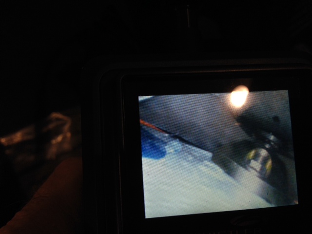

I found the problem with a camera on a snake - those things are really cheap now. $60. I went in through the air brake hole. It revealed that the forward socket pin was not fully engaging as well. I used the old socket as a guide to drill the hole through the metal plate and did not get the hole large enough. The pin was contacting the metal and not going all the way in.
I drilled it out larger and now the pin goes in, the aft pin goes in and I was able to get the wing in with all pins engaged. I checked the dihedral and it is right.

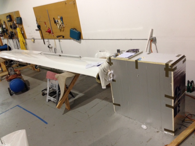

I have the starboard wing in its post cure tonight - pulling an all nighter. That was a change of plans. I chickened out on the thermostatically controlled heater. It was cold soaked overnight and over-reacted. INstead, I went with lights and a small heater in the fan mode only. Trial and error ended up with 388 watts to maintain the 50C. Being paranoid and not wanting to overheat the spar, I have 4 measurements of the temperature. It stabilized in the foam panel oven at the right temperature and there is no risk of over temping the spar tang. It is in an insulated hangar and might drop as the night gets colder. I've got a couple trips to make out there in the middle of the night.

Attached pictures of the cure setup tonight. Almost there!
The remote view of the socket after opening the hole in the fuselage metal. This is not changing anything on the socket - just the plate in the fuselage wall.
The foam panel autoclave. Stable without risk of overheating. Rather than cycle a 1500 watt heater, there is a total of 388 watts of light bulbs. 250 watt halogen, 100 and 38 watt incandescent.
