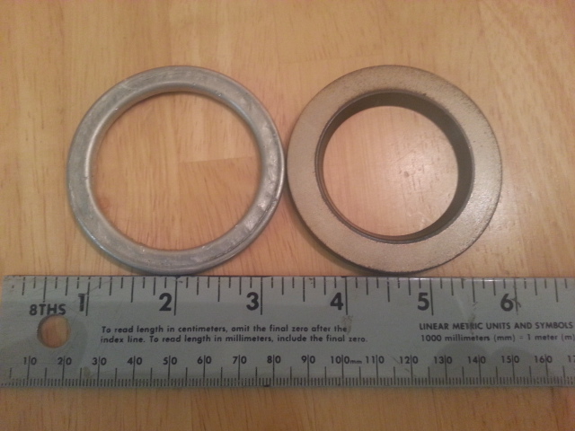

When changing my main tires I ran into a problem with a part on the wheel. On page 46-3 of my plans ,and on the outboard side of the wheel I had an issue with what the plans call "molded grease seal". The original is a narrow channel ring of aluminum. When I ordered what appeared to be the new part from Cleveland I received a rubberized part that has the same outer diameter, but the inner diameter is different. My wheels were part of a kit shipped in '08 so perhaps this has been a change since built, but it just doesn't seem right. Hopefully I have been able to attach a picture with the original on the left (before I dropped it and stepped on it, then tried to straighten it) and the new one on the right. Can anyone either confirm that the new seal is now the correct part, and if so any idea where to get the felt ring to go with it? Or, if it is not the right part, has anyone found the correct part number for Cleveland or aircraft spruce so I can order the correct part?

Grease seal. Old on left new on right
