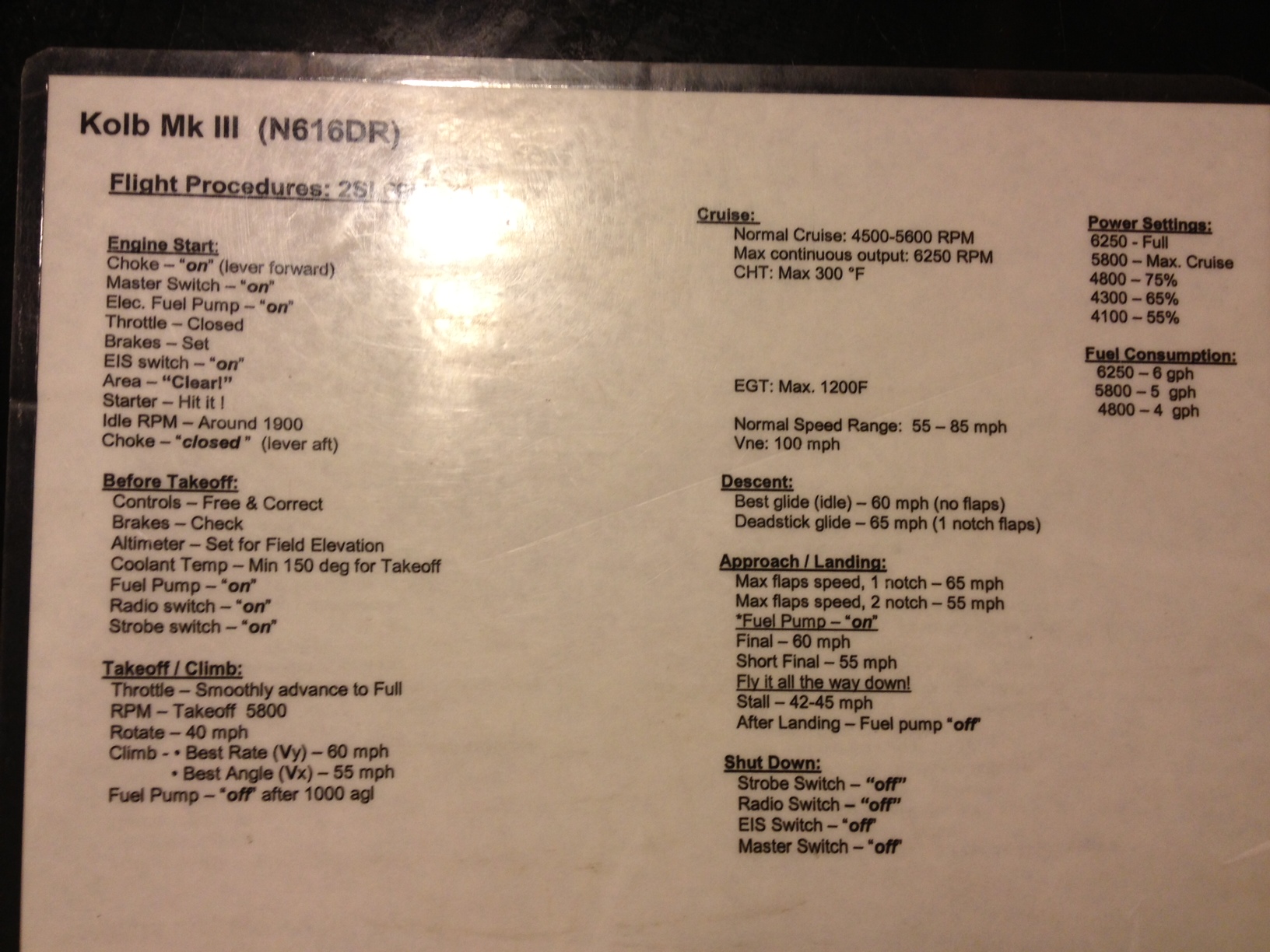

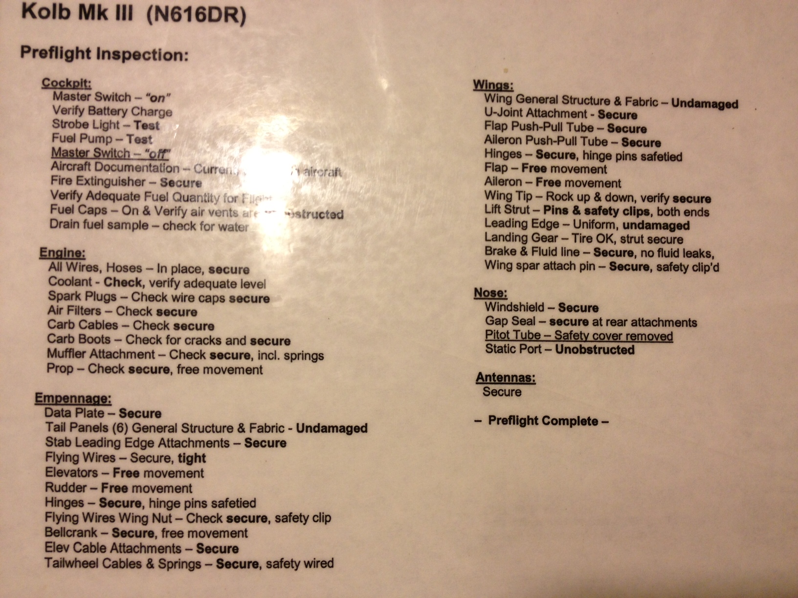

Mike,
Here is the front and back sides of my laminated sheets. These passed my airworthiness inspection as a POH. My engine is single ignition so you will have to edit in your dual ignition check, and you may not want to turn on your EIS (if you use one) until after the engine is started to avoid inductive spikes from the starter motor and solenoid coil that could harm your electronics.
I hope this helps.

awesome! thanks Denny! I appreciate it

Denny,
Is it possible for you to scan and save your POH as a PDF file? That way we could make our
own unique changes and print the POH. It would be much easier than retyping your entire manual.

I have an unfinished (about 80% done) POH I created for my Kolb, in Microsoft Word format.
If anyone wants it, please send me a private email:  rlaird(at)cavediver.com (rlaird(at)cavediver.com)
It's nothing special, and probably begs for improvement, but it was accepted at the time I got my N-number as being adequate.
It was based on a POH I wrote for the Aventura II that I used to own, and the content needs to be reviewed to make sure something leftover from the previous POH didn't get overlooked and included.  Plus, the Appendix needs to be finished (diagrams/photos), which would have to be done by each individual since most of the Kolbs built are a little different.

Mike,
I'll try that when I get a chance, never made a PDF file in my life, but hey, can't be that hard. I'll try to get to it later today.
