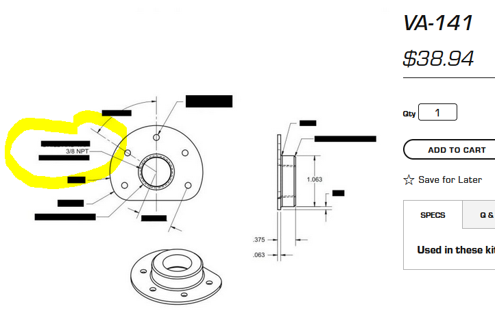

werner schneider
Joined: 24 May 2021
Posts: 62
PostPosted: Thu Apr 18, 2024 2:38 pm    Post subject: VA-141 Plug Size Reply with quote
Tim is right
the info can be found in the shop
[img]cid:part1.oFi69Izj.lV7jDc7x(at)gmx.net[/img]
Cheers Werner

PostPosted: Thu Apr 18, 2024 4:26 pm    Post subject: VA-141 Plug Size Reply with quote
Thanks to you both; Van's confirmed it is indeed 3/8" NPT - it's shown in the RV-14 instructions.
Rodger
